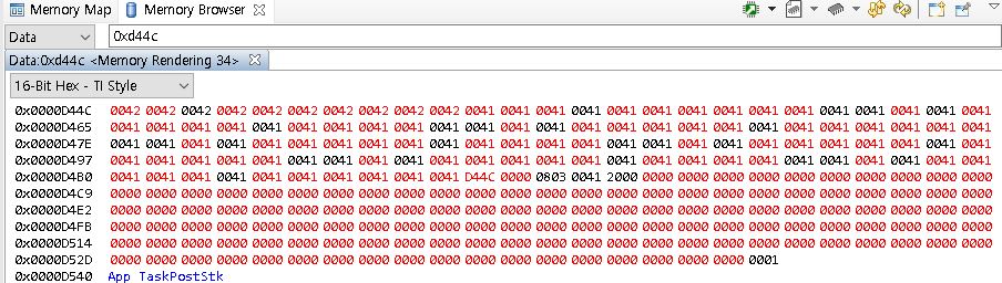

Compiler/TMS320F28335: Are there any cases where an array declared in a user-defined function is placed in the ebss area rather than the stack area?
Part Number: TMS320F28335
After calling the user-defined function from the main function, the array declared in the called function exists in the ebss area, not the stack area.
Why do these cases exist?

And, my sample code is
void stack_overflow()
char overflowable[10]="BBBBBBBBBB";
int len2=100;
int i;
char *buff2;
buff2 = &overflowable;
char s2[100] = {"AAAAAAAAAAAAAAAAAAAAAAAAAAAAAAAAAAAAAAAAAAAAAAAAAAAAAAAAAAAAAAAAAAAAAAAAAAAAAAAAAAAAAAAAAAAAAAAAAAAA"};
memcpy(overflowable, s2, len2);
for(i=0; i<100; i++){
printf("%s", buff2[i]);
please refer to the attached photo for the address and data confirmed through the Memory Browser.
char overflowable[10] array's address id 0xD44C.
Thanks, Regards
Han

  • Your map file includes these lines that show the address of those symbols ...
    1     0000d440  _App_TaskPendStk
    1     0000d540  _App_TaskPostStk
    1     0000d640  _App_TaskStartStk
    Your memory window screen shot starts at address 0xd44c, within range of the symbol _App_TaskPendStk.  The function begins by copying constant strings filled with the character A (0x0041) and B (0x0042) into the local arrays overflowable and s2.  All things considered, it is likely the SP is not within the range of the .stack section, but within the range of the symbol _App_TaskPendStk in the .ebss section.

  • Han SeungJae said:
    1. Can the SP be located in the .ebss section, not the .stack section?
    That's not supposed to happen.  But, that is probably what happened in your case.  You need to investigate to determine whether the SP contains the address for the wrong memory range, and how that occurred.
    Han SeungJae said:
    2. I still don't understand why overflowable and s arrays exist in .ebss rather than .stack.
    Like all local variables, they are accessed at a constant offset from the SP.  If the SP becomes corrupted, their addresses will be corrupted as well.
