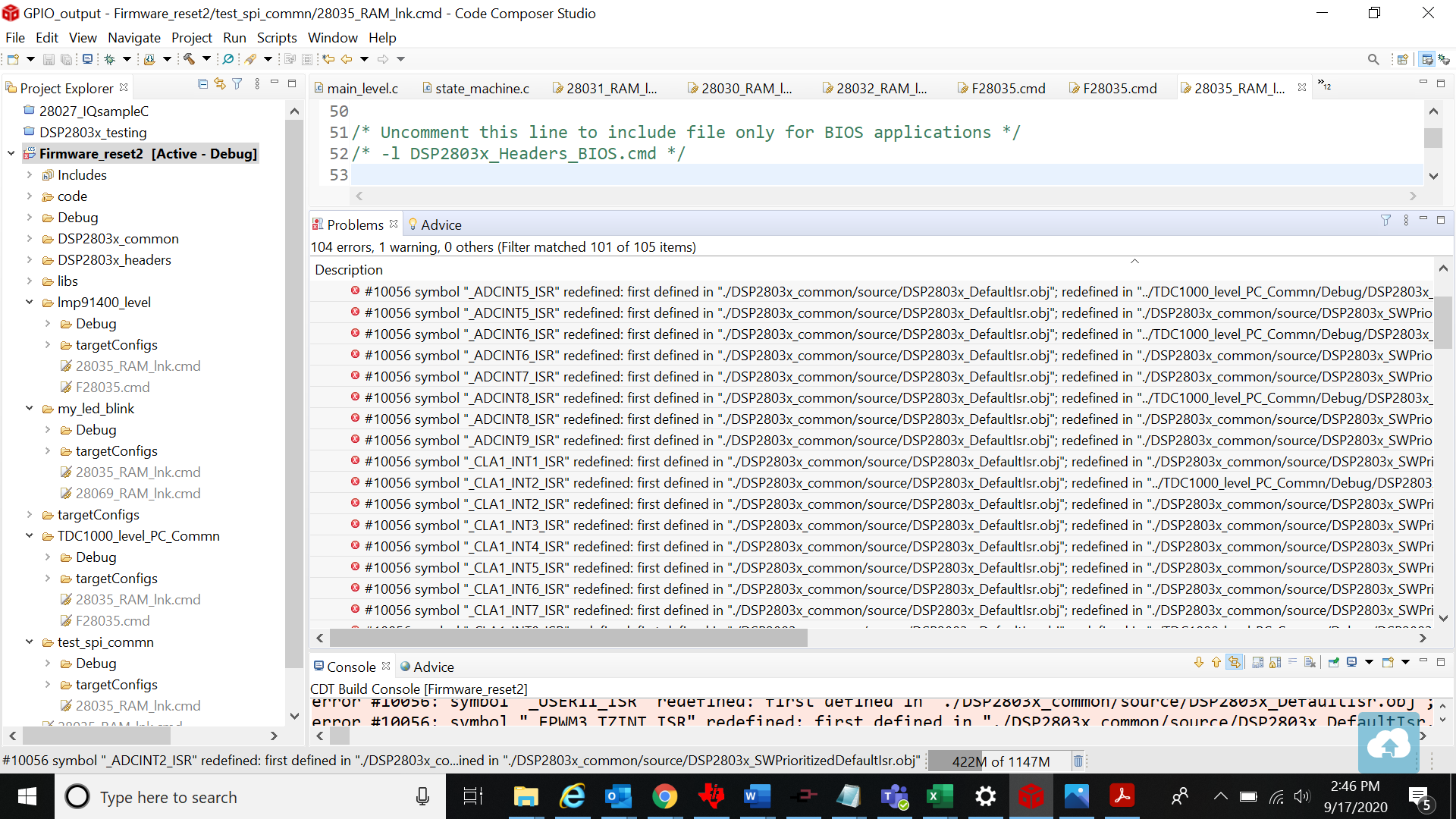

    Can you explain how to do this? I have tried this several times but every time I try this I get several errors right of the bat. I fix those errors just to get more  errors and so on. Something tells me I'm not doing something right from the beginning... I have attached a picture of what my screen looks like at the moment.
    Colin
  • Colin,
    it looks like you are having linking errors. Those comments are telling you that you have defined "xxyy" twice. And then it is pointing to the locations where that definition is happening.
    The forums should have several posts about how to correct linking errors. Additionally the c2000 workshop covers how to correctly link files together.
    https://training.ti.com/c2000-f2803x-microcontroller-workshop?context=1137791-1137784
    Cody

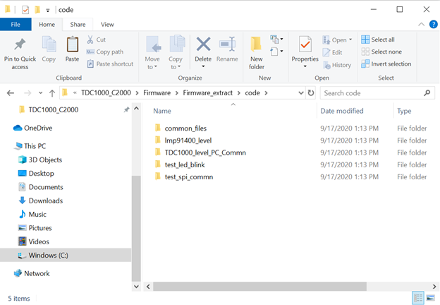

    I made a new ccs project and tried downloading the firmware but every time I do I get errors. I usually tried adding the whole firmware file but this time I instead just added the code and header files from TDC1000_level_PC_Commn and lmp_91400_level files.
    Below is the all the files available in the firmware:
    These are the files under code:
    This is what my CCS looks like at the moment. I opened both of the main_level.c files from TDC1000_level_PC_Commn and lmp_91400_level and am confused as to which one to use. The lmp level is on left and the TDC level is on the right.
    Do I need to add anymore files from the firmware?
    I am also having errors with the TDC1000 host_interface.c and main_level.c. It is not allowing me to make changes to these files and save them. I think it has something to do with a copyright issue.

    I was able to extract the files and saved it as firmware_extract as seen in the above pictures. When I import this file and try to build it, I get a bunch of errors. I think there ends up being too many files because I have to exclude a lot of them from the build to fix the errors. I don't know if I'm excluding the proper files.
    Can you also touch base on the difference between the TDC1000_level_PC_Commn and lmp_91400_level files? They are both located in the firmware file but no where does it describe the difference. I also cannot find the lmp91400 anywhere on the board.
    Colin
  • Colin,
    I recognize this is probably pretty frustrating for you so to help close this issue more quickly I imported and built the TDC1000_level_PC_Commn  project.
    In doing so I found 3 issues.
    1. The linking was done using absolute file paths.
      1. There are two ways to fix this, correct this to use relative file paths or just update the absolute file paths to where you have located the files in your file system.
        1. Right click on the project name in the project explorer and click on ""properties"
        2. Navigate to "Build"-> "C2000 compilier" -> "include options"
        3. replace "C:\Users\a0415888\Documents\pwd\GIT_REPOS\C2000\c2000_lmp91400" with the file path on your system for each of the include
    2. //#include <cstring> was causing a compile error
      1. To fix: replace all instances (3 if I remember correctly) with " #include <string.h> "
    3. IQmath.lib wasn't found
      1. You can link to this or "add" it to the project.
        1. Right click on the project name in the project explorer and click on "add files"
        2. Navigate to "TDC1000_C2000EVM_FW-Source-v1.42\libs\math\IQmath\v160\lib"
        3. Select IQmath.lib.
        4. Linking or copying the file is OK
    I am not sure why the LMP files are included, but as far as I know you only need the TDC files.
