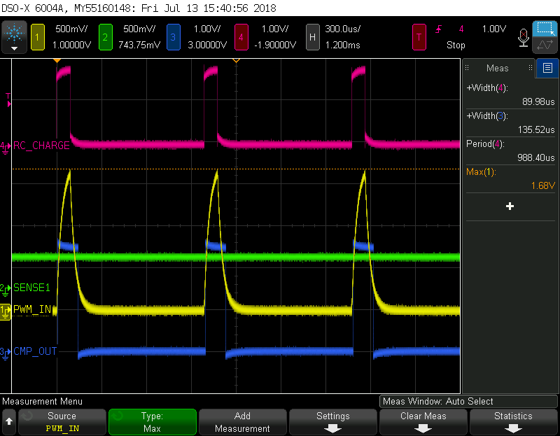

My customer read the photodetector value in the lamp. The value is not consistence with different board.
Test flow:
-input the fixed voltage(0.45V) on sense_1 as channel 2 in waveform below.
-read the photodiode value through NIRSCAN NANO GUI. And the data is different with board. it seems there is 20% deviation with correct value. And the data changes with board.
Can you explain how it reads the sensor data?
How accurate is the result and how to improve it?
