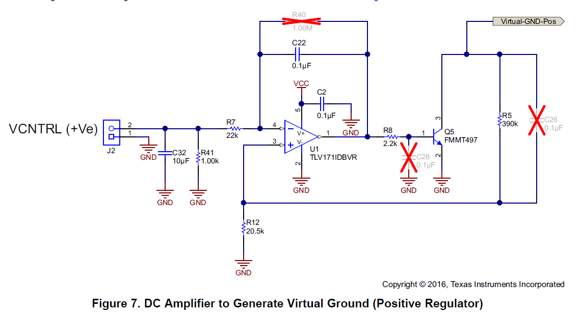

1. R40,R38, one 1MΩ shunt resistor is in parallel with a feedback cap of a opamp as an integrator, Both are cancelled with a red cross in datasheet, but are still in the schematic of Altium
What is the purpose of these 1MΩ resistor? the bleeding resistor to reset the integrator? Shall I keep them on board?
2.  C26, C28  are also cancelled in the datasheet,
What function do they play in circuit, why are they cancelled in datasheet? Shall I keep them on board?

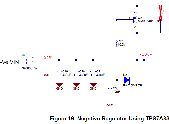

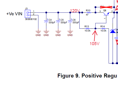

5.  R36 and R9 are zero Ω . The shorted BJT Q8 and Q6, which control the input voltage of those LDOs. If they are cancelled for other temporary purpose, why they appear in the schematic of Altium?

    1) R40 & R38 simply introduce a DC negative feedback. If you have space in your layout, I would recommend to keep the footprint of the resistors.
    2) C26 & C28 were kept to see if we need to filter out any noise during the development. While testing, you can always try different cap values and see the filtering operation.

    5) R36 & R9 were used temporarily. You can remove those in your design.

    Today I tried to pull 1A current at 10V from the positive part, while the positive circuit is driven by +64DCV.  A few seconds later, the circuit failed and the +64DCV source went into constant current mode.  Then I unloaded the load resistor and re-powered this circuit, suddenly suspect  Q5 BJT was burnt.
    The control part key voltage is provided on top of Figure 7 of tiduci3a.pdf.
    Doesn't this circuit support a continues current output, even the constant current is a fraction of the rated 6A?
    According to the voltage value measured at the circuit nodes of Figure 7, can we conclude that Q5 was burnt to be broken-circuit?

    The circuit should work for continuous Iout of 1A.
    For 0.5V input, the virtual ground point should be at 10V. Where did you get 64V from?
    The virtual ground point is automatically generated.
    Which transistor did you use for Q5?
    I am attaching TINA simulation file which you can try before testing the actual circuit.
