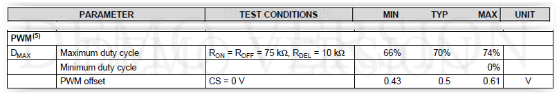

According to PMP5123 design, if the Vin=8V, the duty cycle will be Duty=ton/T=4.1us/5.6us=73.2%, it's very close to the maximum duty cycle value 74% in the datasheet.

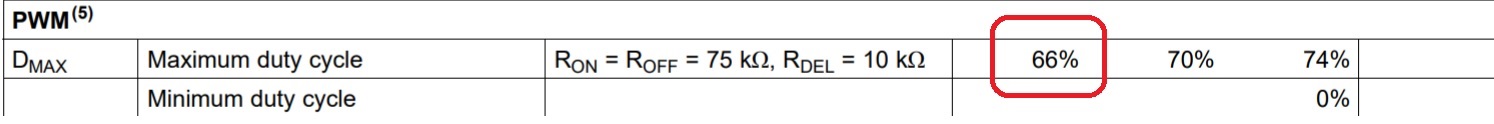

1. How could we make sure the the UCC2897A can work properly if the minimum duty cycle is 66% but the design condition is 73.2%?
2. Can UCC2897A be operated in 80% duty cycle design? What modification that we need to do on PMP5123?
