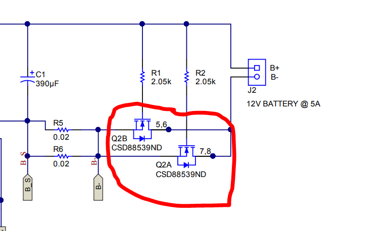

TIDA-00476: Any suggestions why Q2 is blown-up when connecting a 44V panel
Part Number: TIDA-00476
I want to use this design for  22/44V panels  but when I connect a 44V panel Q2 is blown-up.
I did somes test with less powerfull sunlight and it seems to work, but now when rhe sun is more powerfull
Q2 blown-up.  With one board also a 7,5A fuse was also blown (fuse in series with + battery).
With a 22V panel I have no problem.
I thought about a 12V zener between the gate and the source, but it seems to me that the Q2 voltage is never reach the voltage limits?
Any suggestions where to look?
