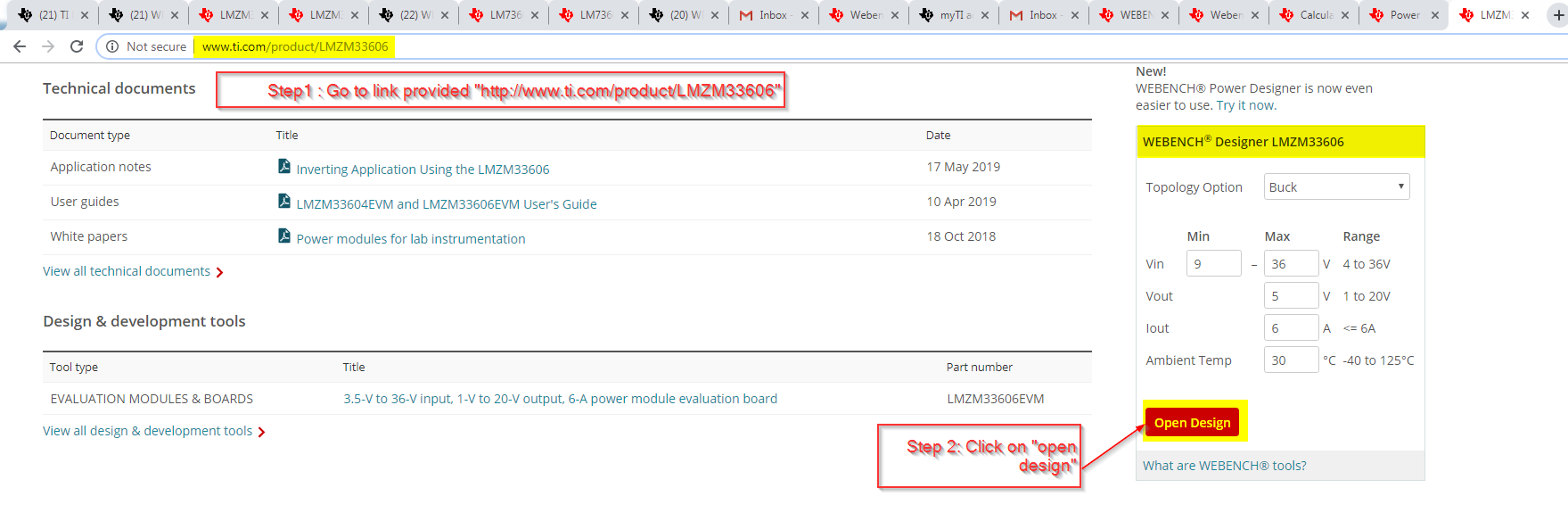

Hi User,
EVM document for the device LMZM33606 has Efficiency vs Iout curve,from which loss could be estimated as
EVM document could be obtained from the link mentioned below.
https://www.ti.com/lit/ug/snvu594b/snvu594b.pdf
Webench designer could also help you to obtain magnitude of each loss for the desired input condition.
Below is the link to access Webench designer.
http://www.ti.com/product/LMZM33606
Please follow the steps mentioned below to create the design in Webench designer.
Kindly revert back to us on any further queries.
