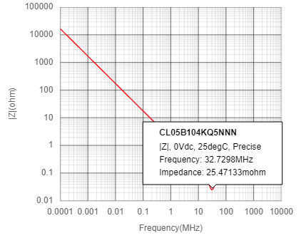

For example, the impedance curve for the frequency value at 100 nF cap is shown below.
At this time, I want to obtain the value of the impedance curve for the frequency value in TINA Simulation. Can you tell me how to simulate?

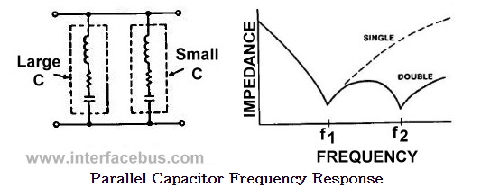

Also, as shown in the figure below, the parallel configuration of the large cap and small cap affects the frequency-impedance curve. Can you figure out how to simulate this configuration?
