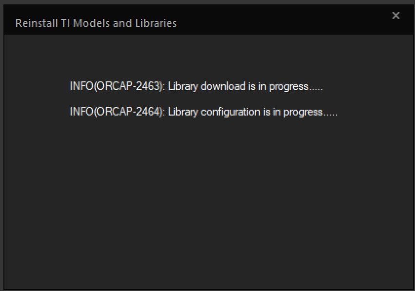

manually updated my PSpice for TI library thru the Help tap and after restarting it actually is downloading and installing a ne Library.
See encose screenshoot:
When checling my installation it still shows
Your Pspice for TI Installation
Bertram,
TI publishes simulation models constantly, hence the regular model library update is incremental. What you initiated is to sync the library to the initial state. You will get additional prompt for library update which when accepted, will give you those incremental changes the next time you launch the tool.
JC
