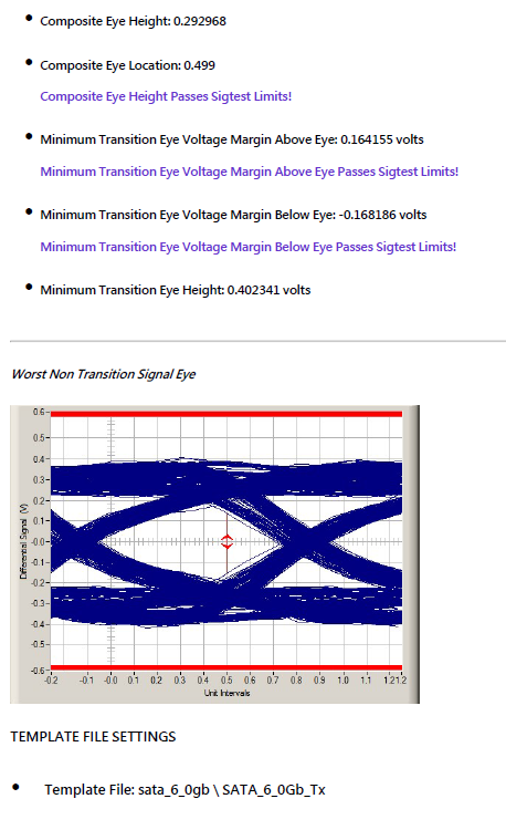

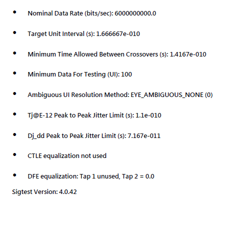

I have to do SI analysis on my board which has Kintex-7 FPGA in it. My SI analysis will be done for SATA 3.0 protocol which will be 6Gbps. My customer has provided SI analysis report done for his board. I referred TIDA-00423 and the sigtest parameters are similar to SI analysis report I have. Can you please let me know how to determine respective parameters are within the required limit.   I am attaching the SI test values provided by my customer.
