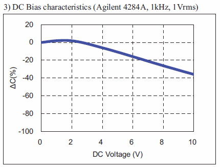

    For anyone reading this thread that is not very familiar with the effect of DC bias on a ceramic capacitor, I have found a few examples that illustrate how radically different it can be from one capacitor to another. This is why I said before that it isn't possible to make a very accurate formula to correct for DC bias. Here are two capacitors from the same manufacturer that have the same exact case size, same capacitance, same tolerance, and same dielectric, but their DC bias performance is surprising to me. At 10V DC bias, the capacitor rated for 10V is only down about 40%. The capacitor rated for 25V is down about 70% at 10V. And to top it off, the 10V capacitor costs less.
    Samsung CL31A106KPHNNNF
    1206, X5R, 10uF, ±10%, 10V
    Samsung CL31A106KAHNNNE
    1206, X5R, 10uF, ±10%,  25V
    As a disclaimer I need to say that I am not an authority on capacitors, and it is possible that Samsung made a mistake in their data sheet.  Or I made a mistake in interpreting the data.
