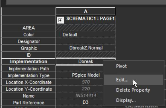

  3. Now, select the instance and right click, then select “Edit Properties”:
  4. Right click the property “Implementation” and select “Edit”:
  5. Enter the name of your own diode model:
  6. OK the pop-up, close the property editor and OK the undo warning.
