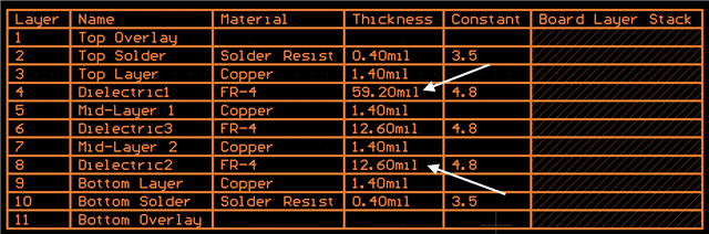

I have a couple of questions about the design reference TIDA-00663.
1) I am trying to build the TIDA-00663. However, the manufacturer of the PCB noticed that the stack-up could have some problems. In particular, there could be a bow and twist due to the high difference between the thicknesses of layer 4 and layer 8. Is the stack-up (with the order defined by the “Layer” column) in the Gerber file correct ? In this case, how do you suggest to solve this problem?

  • Hi Giovanni,
    Yes the Gerber that you find in the TIDA-00663 page is the one we used to manufacture the boards. We have not faced this problem during the tests of this design.

  • Thank you so much for your prompt response, Giovanni. I really appreciate your help.
    Unfortunately, I received a new feedback from the PCB manufacturer, who is still concerned about the asymmetry (between layer 4 and 8) of the stackup. According to the manufacturer, this would lead to bow and twist (higher than 0.75%), and, consequently, problems in the assembly of SMD components.
    Do you suggest other possibilities to fabricate the PCB without bow and twist? Can I reduce or increase some layers (without performance problems) to make the PCB less asymmetric and avoid bow and twist?
    Moreover, I noticed that the sum of the thicknesses of the layers in the stackup (90.8 mil) in the GERBER file doesn't match the thickness of the PCB (62 mil) in the same GERBER file. Is there something I am missing?

  • Hi Giovanni,
    Let me check with the manufacturer that we worked with to build this reference design and I will come back to you by latest the end of the week.
    Giovanni
  • Hi Giovanni,
    You can go ahead and reduce or increase some layers, according to your manufacturers requirements, to make the PCB less asymmetric.
    Giovanni

    Sorry for my late answer and thank you very much for your help. I really appreciated it. I still have some questions about the realization of the PCB.
    1) I followed your advice and made the thicknesses of the dielectric layers symmetric. So, as far as I understand, no impedance control is required for this PCB. Can you confirm it?

  • Hi Giovanni,
    We have not implemented any impedance control in this design.
