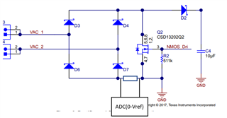

we want to use the energy harvesting reference design to power up a system with peak consumption 50mA, but we also would like to measure the current of the CT by using an ADC. Is there a reference design for this? Do we have to "separate" the 2 operations i.e. charging/supplying the current to the system and measurement or is it feasible simultaneously?

    If your design is not very sensitive to efficiency, you can connect a sampling resistor or uses a Hall sensor:
    Solution1:
    This solution measures the rectified current, which is the absolute value of your CT current.

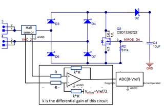

    Solution 2:
    This solution can measure the AC side current with an DC offset.

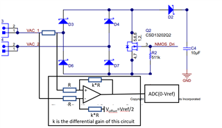

    Solution 3:
    This solution provides isolation between power circuit and signal circuit and therefore have better reliability.

    thank you for your prompt response. It was very useful. In our application we would like to measure the AC current so that we can calculate and measure several parameters other than the absolute value of the current.
    I have some further questions/doubts:
    • We are using a differential ADC that has a max range of 600mV on each side. How would we feed the signal to it?
    • Would you please suggest us a hall sensor for this application? The max current in the secondary of the CT is 1A in our case.

    1. Please check the datasheet and see if you can connect one ADC input to GND and use it as a single-ended ADC. And you can reach to the support team of that ADC for further advise.
    2.Same reason as 1, I shouldn't be giving advise on that Hall since it's not our product.
