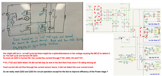

Failure mode-2:
Tested with power source with Harmonics:
Test started at 230Vac, 60Hz and ran for almost 2Hrs without any fault then the voltage is reduced to 187Vac. After running for 10-15min at 187Vac, Board is damaged and the Failure analysis revealed that low side Bridge FET damaged and the fuses on the board opened.
Below is the FA for reference. I suspect that the root cause was a false zero cross detection that mis switched the Low Side Bridge FET when Input voltage is  in -Ve half cycle might be due to spike/distortion at zero crossing.
Did anyone faced this issue and if yes, how did it get resolved ? How to make the PFC design robust to withstand input voltage harmonics ?
    You can stop the low frequency MOSFET trigger at beginning, and enable it after your control loop is stable and robust.
    For your control loop, oscillation maybe caused by your weak source impedance. You can try to slow down the current loop and voltage loop by smaller Kp and Ki.
