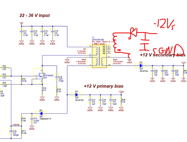

1) I see that Q1 and U1 with R9/R10 are used as a linear regulator, with Vout ~ 10V why not 12V ?
and why is it connected to +12Vp through a diode afterwards ?
2) R20 & R21 are dummy loads, in real application they should be removed ?
or they draw minimum amount of current to keep the regulation stable ?
Thanks!
Mohamed
  • Hi Mohamed,
    1. The linear regulator is used for start-up. After the flyback is up and running the 12Vp generated by the flyback is used to bias the flyback controller.
    2. The resistors are used to improve the cross regulation for the two outputs in this design. A common drawback to PSR flybacks is how the unregulated outputs can fly up if they are kept unloaded, and the dummy load assists with this. Since the controller will draw current through operation, having that load tied to 12Vp helps to reduce the amount of dummy loading needed for that output.

  • Hi John,
    Thanks for your reply, for the second point how do you size these resistors ?
    if we want to have an aux negative supply, can the same schematic be used but with the addition of another winding on the sec side the recpricoal of what exists now like the below picture ? how would the current rating be affected ?

  • Hi Mohamed,
    The resistor value will depend on how much loading is required to stay within a certain regulation range. This is best done in lab where you adjust the cross loading between the multiple outputs until the Vout range stays within the preferred range. Then for sizing you should consider the power loss that the resistor will burn for the specific voltage it operates at. It is difficult to have an exact calculation or simulation since the cross loading is dependent on the transformer winding structure.
    Are the +/- outputs the same voltage and current stress? We have another circuit where you add a ceramic cap between the switch node on the secondary side which really helps out the cross regulation and reduces the amount of pre-load needed. Here's the link to Power Tip #85 on EDN: https://www.edn.com/power-tips-85-adding-a-single-capacitor-to-improve-cross-regulation-in-dual-output-flyback-power-supplies/
    Figure 1 highlights the design you should consider using.
    John
