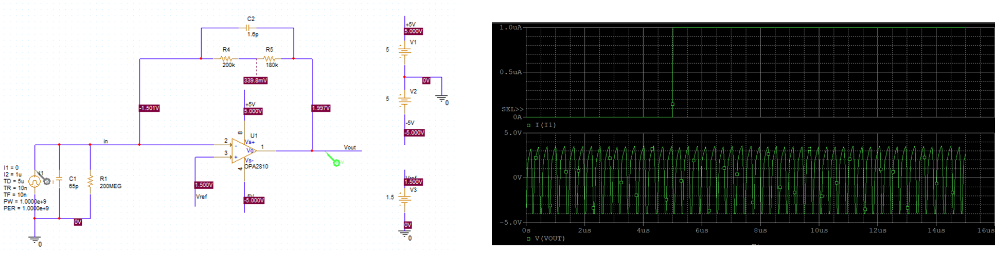

I'm performing TIA simulation for OPA2810 and OPA810.
When I use OPA810, I could get almost expected output voltage as shown below.
However when I use OPA2810 which is dual channel version of OPA810, I could observe storange behavior as shown below.
OPA810 :
OPA2810 :
It seems that behavior of OPA2810 model is a little bit storange.
Could you please check whether there is no problem for spice model of OPA2810 or not ?

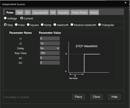

    Thank you for your reply.
     >is PW and PER suppose to be 1e+9s?
    I just set "Step" response as shown below. I did not set "PW" and "PER" intentionally.
    >I will be able to replicate it in PSpice by tomorrow as well.

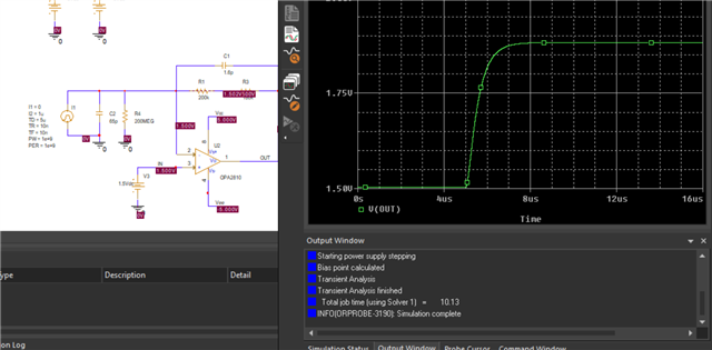

  • Hello Machida-san,
      I was able to run it on PSpice for TI, and was able to get the same output for both devices.
      Would you be able to run the attached project on your end? It might be an older version of OPA2810, if it works on your end, can you compare the dates on the netlist?
    I could confirm your attached project worked correctly.
    However, when I just changed OPA2810, I saw issue.

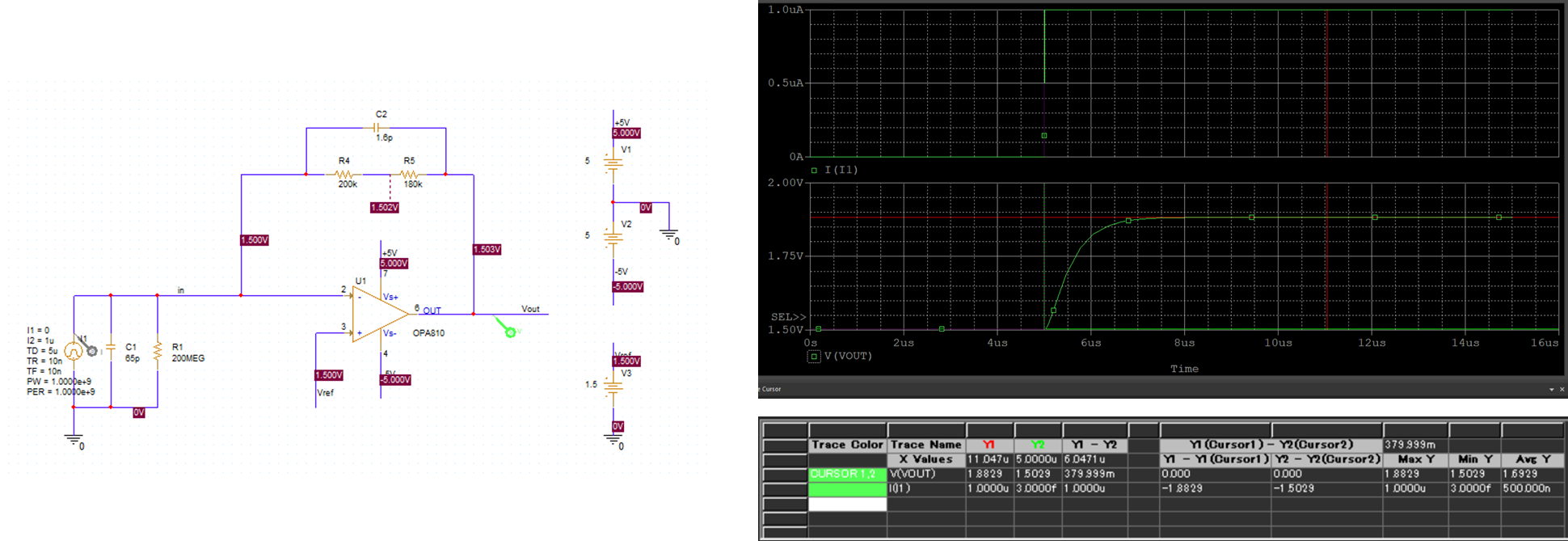

    Here is your model and my model information.
    It seems that model version is same...
    Your model
    Model which I changed OPA2810 on my side
  • In addition, I also tried that I copied only symbol of OPA2810 from your attached project to my original project.
    As a result, I could observe expected result. So, it seems that there is problem on library of OPA2810.
    However, as I described previous thread, it seems that revision of each lib file is same...
    Now, I will use lib file of OPA2810 which I copied from your project to proceed evaluation. However I would like to investigate what is root cause of this problem..
