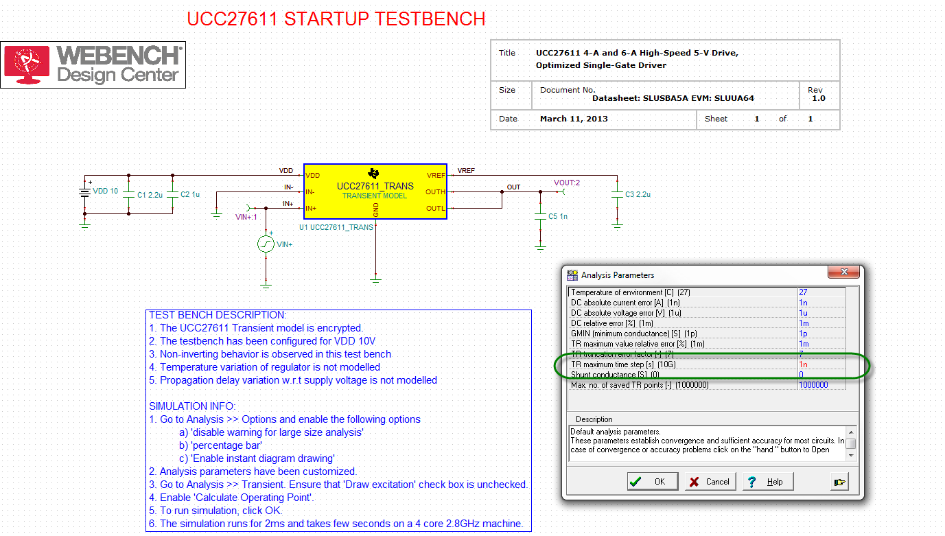

Attempting to run this model in LT Spice.  Keep getting an error that it doesn't recognize the subcircuit call X_U3_U4.  This call is internal to the UCC27611 model.  I do not believe it is related to LT Spice.  Can you help?
  • Michael,
    We are unable to support LTSpice, but I did verify that this is a problem with the model since it is using an inbuilt gate in PSpice. In order to fix this, please use the following model.
    UCC27611_TRANS.LIB

  • Hi Ivan,
    The rise time depends on the accuracy that you set in your simulator. If the accuracy is too loose, you will see very sharp rise and fall time. As a test, I tightened the time step in TINA-TI  and got reasonably accurate rise time of ~ 8-9ns.
    As far as VDD and VREF currents are concerned, these have not been modeled as it is a behavioral model. As a general rule TI's spice models should not be used to calculate efficiency. We have however modeled the current limits on the Sourcing and Sinking.
    Best regrads,
  • Hi Nikhil,
    thank you for verification. I changes settings (RELTOL 0.1m) and I get now rise/fall time. But only when I use capacitive load - in contrast I need an inductive load where the model is still very sharp... OK, I understand the model was not tuned for it that's fine.
