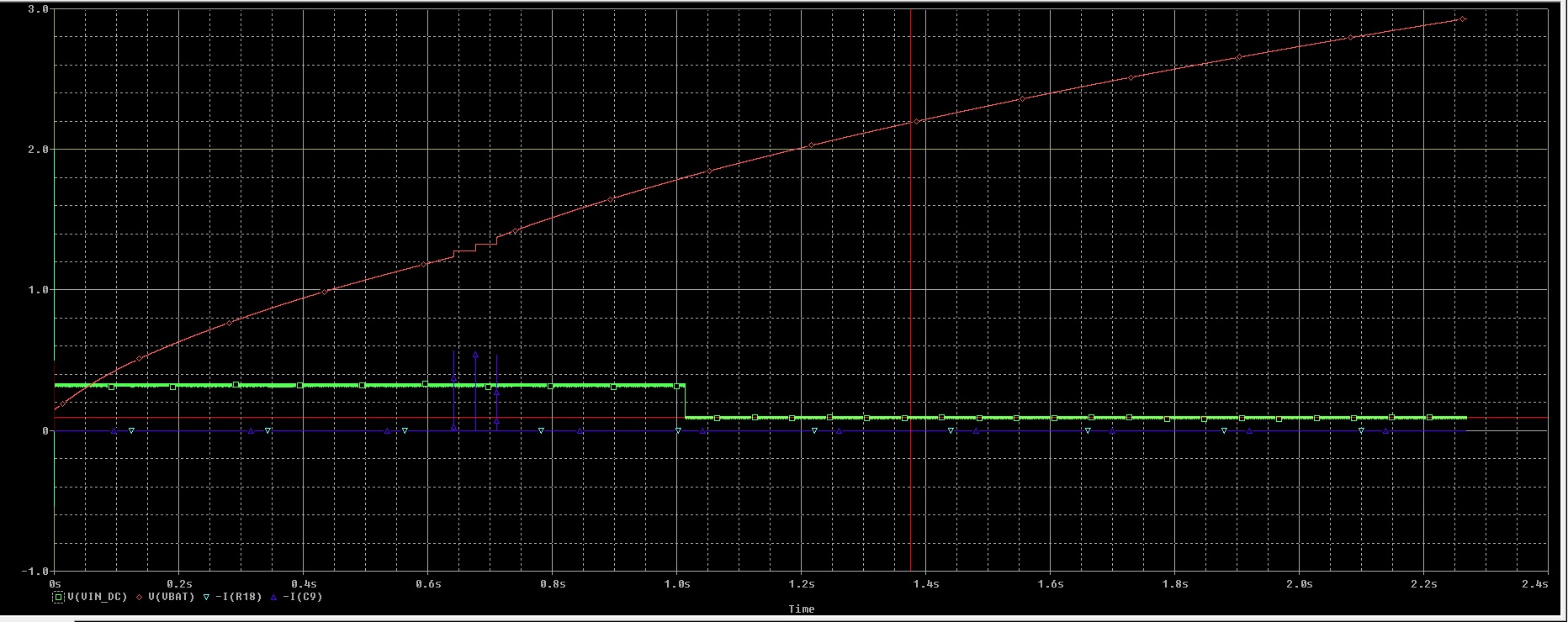

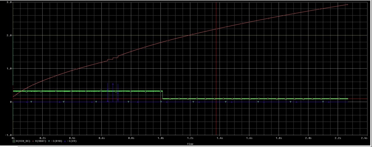

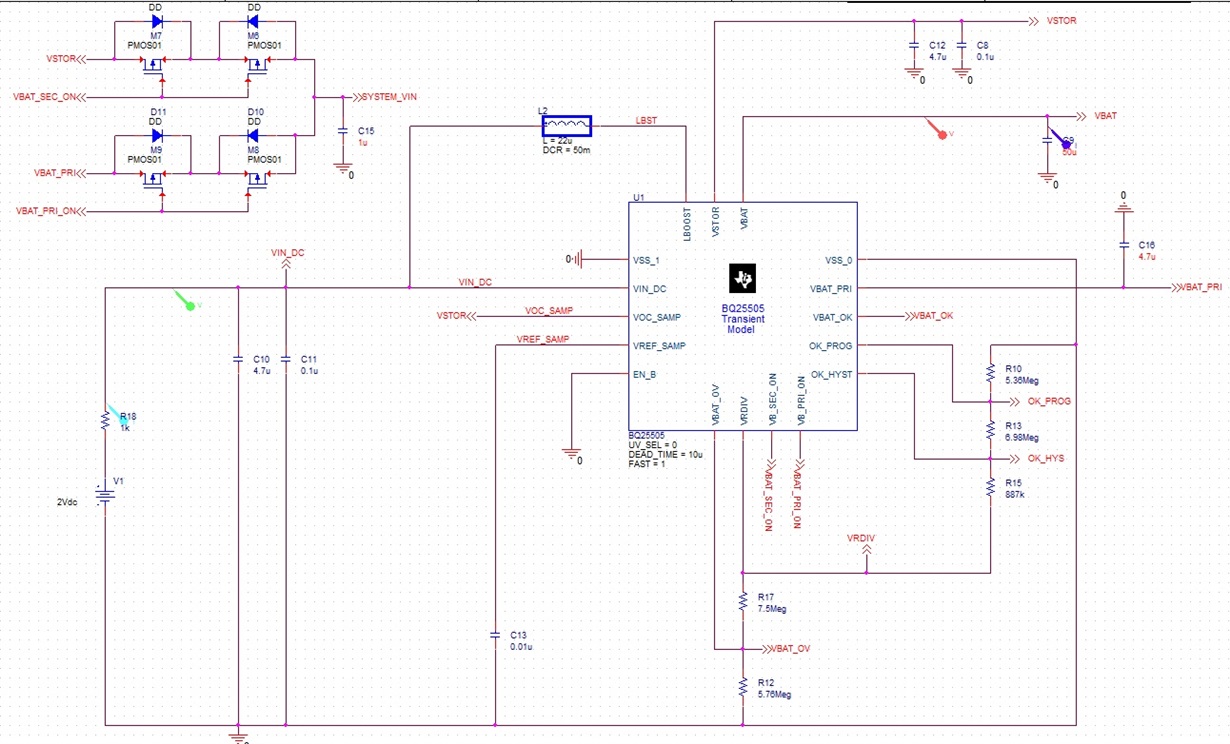

Hi all,

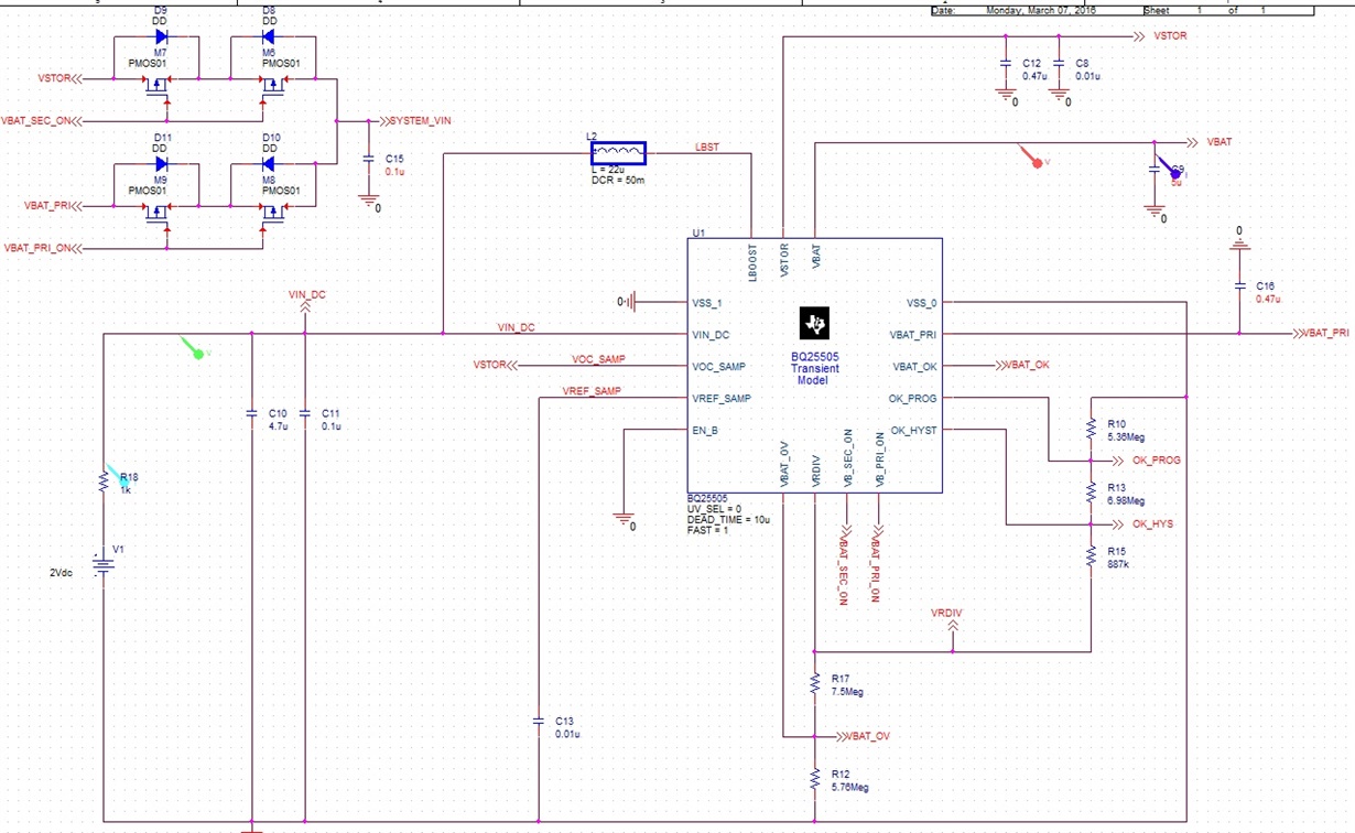

I am asking about the PSpice model for the BQ25505 battery management circuit. I got the PSpice model from TI website, and put a DC voltage source input of 2V and an internal resistance 1kOhm, and a storage capacitor of 50uA connected to VBAT pin.
The undervoltage setting is at 1.77V which means that the main booster will work starting from this voltage. VOC_SAMP pin is connected to VSTOR which means an 80% MPPT setting.

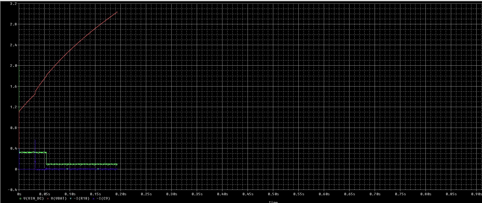

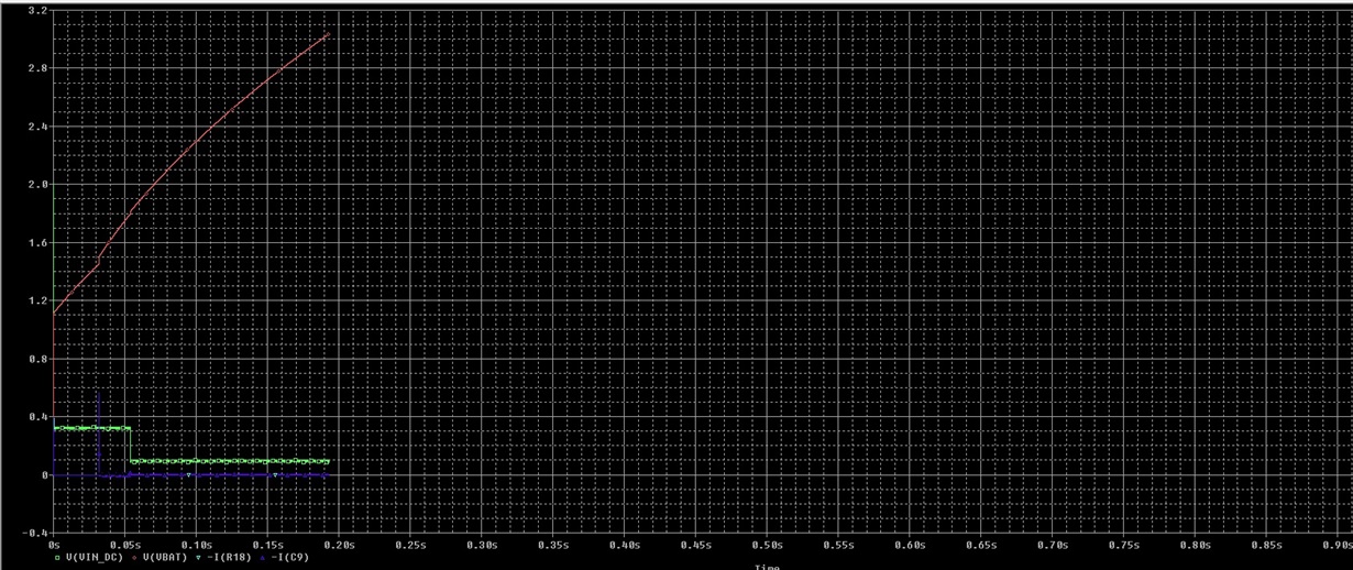

So, as much as I understand, the input voltage will be set to 0.8*2=1.6V at main booster operation. However, I got the input voltage clamped at 0.1V (after 0.33V cold start voltage). I tried different input voltages 1V and 1.5V and still the input voltage seems to clamp at 0.1V during main boost.
Did anyone face the same problem? It seems the MPPT feature is not working.
Appreciate any help from you all,
