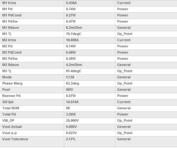

Webench Designer Rdson & PdCond values are 0 in Op Vals report - actual efficiency may be much lower than stated.
Other Parts Discussed in Thread: LM25116, TPS40170, CSD18503Q5A, CSD18504Q5A
Below is a link to an LM25116 design I'm working on. M1/M2 Rdson & PdCond values are 0 in the Op Vals report. Is this a bug or am I missing something?

    Actually, that is the proper way to post a link to the design. However, when I open it, all of the values are calculated:

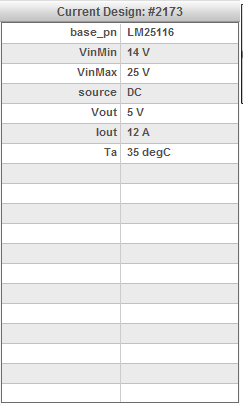

    Here is the design description that opened:
    Could you try to open the link yourself (not by accessing your original design, but from the public share link) to see if this works for you?

    When I open the design from the link above all values are calculated as you found.

    I just noticed that the entire design was regenerated with different components, frequency, etc. so I think my problem is related to the components in my original design. If you open my DesignId=66 I think you'll see the 0 values.

  • I think the problem is related to the Infineon BSC340N08NS3 G FETs. It is only when these FETs are used that Rdson=0 & PdCond=0 in the Op Vals report. The RDSon values look OK in the schematic editor. Are ohms and mohms being confused somewhere?

    A couple of things. First, evidently you placed a link to the "default" design created from the product folder. In order to public share the design you had created, use the share design feature and select Share with Public. This will create a link that you can cut and post into the forum that will allow us to pull your design directly.
    Second, I have confirmed the issue with the design and I have sent it to one of our developers to evaluate. Not sure of the root cause yet, but the efficiency plots and some strange numbers occurred when I was playing with the OpVals at different currents and voltages. I do suspect something in the FET library, but I cannot be sure yet.

    Our team is looking at it now. Evidently, it looks like some of the data in the database for the component was missing from an update for the component. I'll let you know as soon as I have an update. Apologies for the delay.

    Please accept my apologies for the inconveniences you faced with WEBENCH design creation between July 25th-August12th.  If you re-created your original design(from January) between July25th-July29th you should have run into the Rdson'0', Pcond '0' error. A temporary fix was placed on July29th, where you could not replicate the Rdson'0' issue any more, but the design perhaps didn't make sense between July29th-August12th.
    A proper fix related to Rdsons was released on August 12th and what you see now in your designs is what you can expect.
    I have re-created your original design from 1/21/16 with optimizer knob=2 and FSW=270kHz and below is the new pdf report along with the new design.  You may notice that the power dissipation from FETs has slightly changed from your original report , this is correctly reflecting the updates we have made to the FET database recently for TI NexFETs. Overall efficiency has shifted from 92.101% in January to 92% now reflecting again, the FET updates.
