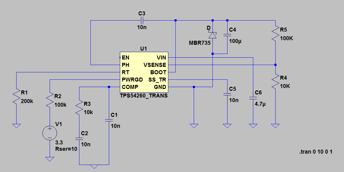

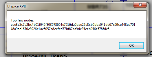

Please see the attached for the images of the simulation model and the error message thrown by LTSpice simulation.
Hi Ajeya,
Please note that TI is not allowed to use or debug LTSpice issues when customer is using TI PSpice models in LTSpice. The LTSpice EULA prohibits us from using it for our products. This particular model is encrypted and will work in PSPICE version 15.7 and above.
