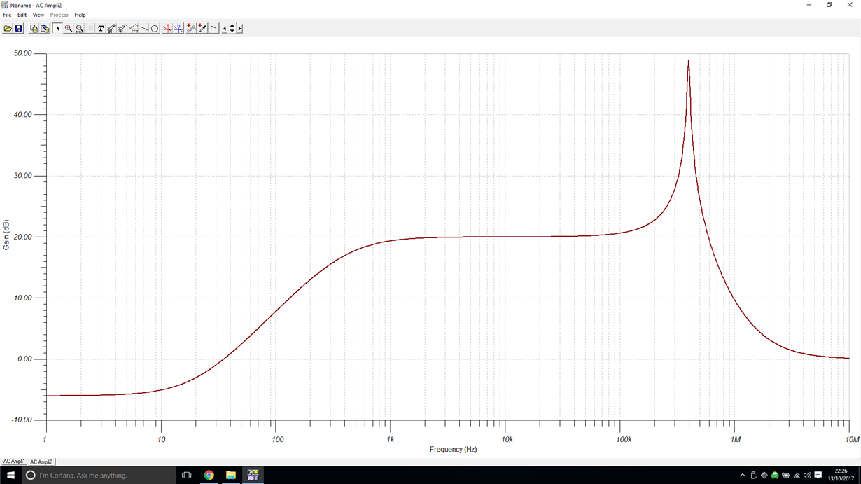

Hi guys,
I have designed an active high pass filter, which when using an ideal op amp gives a perfect response (as expected), however when using a real op amp I am getting some sort of a spike at the higher end of the scale. Does anyone know what is likely causing this, and if so, how I can rectify the issue? I have attached some images and the .TSC file, just in case.
Thanks in advance,
Gareth
High Pass Filter Real Amp.TSC
  • Gareth,
    The peak indicates a high frequency instability. You can see this with a transient pulse response below.
    It shows the expected behavior for a high-pass filter, but there is extra high frequency ringing after each transition.
    The most likely cause of the instability is the op amp's parasitic capacitance and/or open-loop response interacting with the filter components.

  • Hi John,
    Thank you very much for your reply, and I'm glad that it is not just something that I have done wrong!
