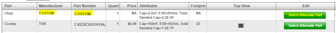

  • Hi Justinas,

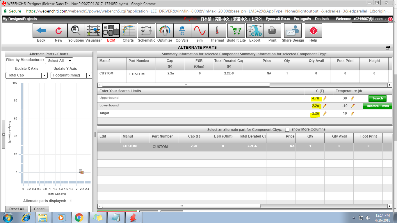

         Cbyp is custom part in WEBENCH BoM and this resulted in export issue. Please follow the below steps to resolve the issue.
    Step 1 : Select alternate part .
    Step 2 : Enter the lower bound, upper bound and target Capacitance values and click on Search.
    Step 3 : Pick the desired component from the list of parts.
    Repeat the above steps for all custom parts in WEBENCH BoM.
    Please share the design if the above mentioned steps do not resolve the issue.
