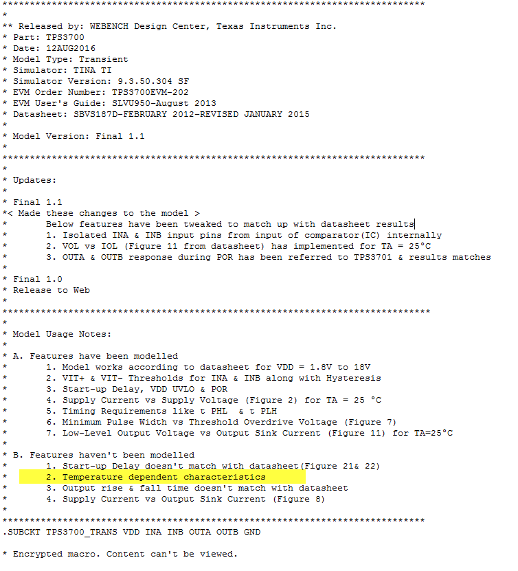

I'm doing a temperature simulation with the TPS3700 in LTspice (since I don't know how to do in TINA), and I'm seeing strange behaviour on INA/OUTA: results/output is always zero if temperature is below 25°C where INB/OUTB seems to be correct. Double checked my calculations that's not the issue.
I replaced TI part by LT part, and the it works so I assume there's something odd with the model. Maybe someone here can check this?
