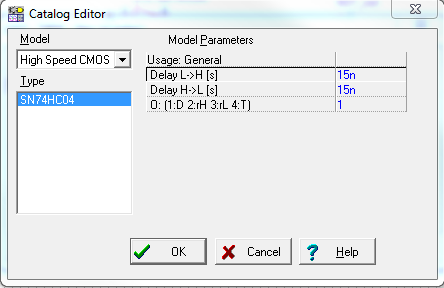

  • Aidan,
    The logic devices you mentioned are ideal devices embedded in TINA-TI.
    They don't necessarily reflect the specs in actual device data sheets.
    You can modify those models by first double-clicking on the symbol, and then editing the fields in the Properties pop-up window.
    For example, you can change the delay by double-clicking on the pop-up's Catalog field and entering the desired values (in seconds) in the Catalog Editor's two Delay fields a shown below.
    Similar changes can be made in the DC Transfer, Input, and Output fields by clicking on the field and then selecting an entry  that field's pull-down menu.
    I hope this helps.
    Please let me know if you have any questions.
    John
