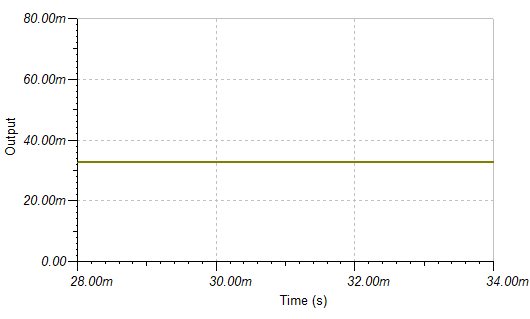

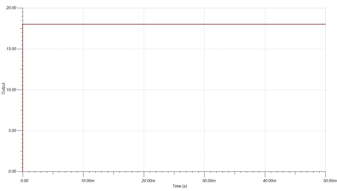

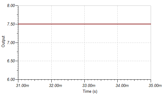

  • Hi Youhao,
    Thank you for replying.
    Here are the values of the mentioned voltages:
    VDIS/EN = 32.72mV
    VDD = 18V
    VFB = 52mV ~ 53mV
    VBP = 7.5V
    Yilong
