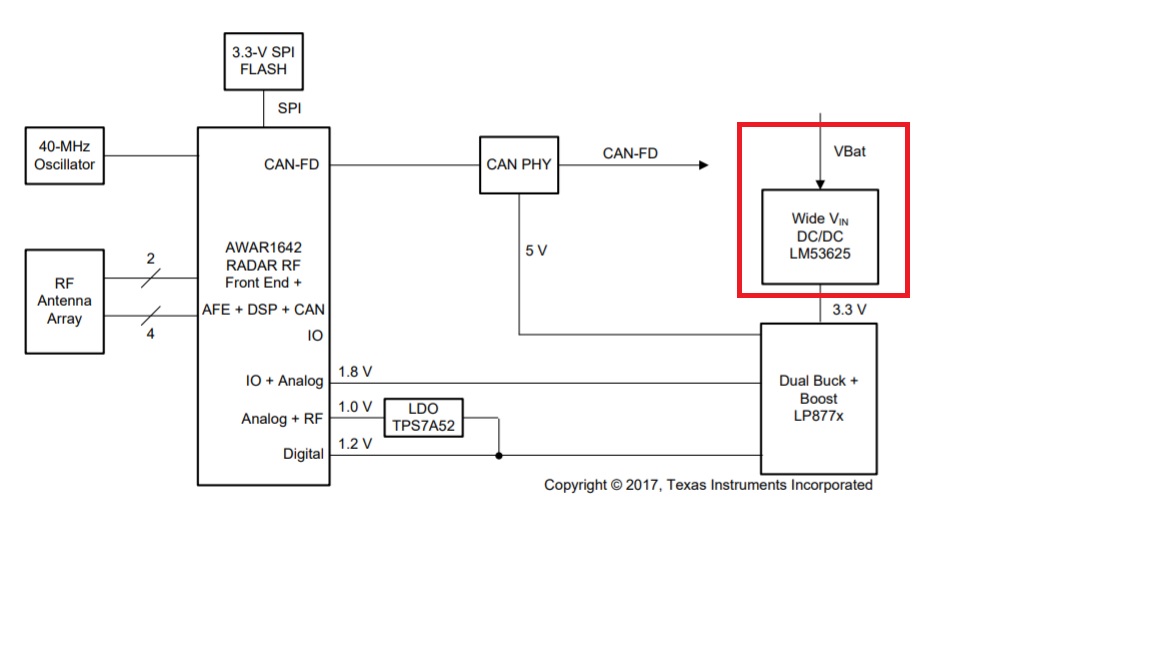

Refer TIDA-01570, input power system(LM536253), can pass ISO7637 test?
or have another modify suggestion.

Hi Steven,
The TIDA-01570 was designed for an input voltage range up to 36 V, with transient tolerance up to 42 V. It has not been tested to meet ISO 7637.
