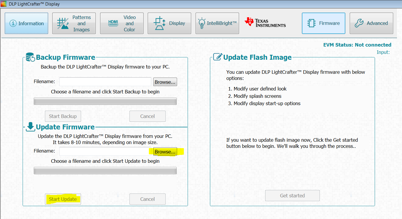

  • Hi Navneet
    Thank you very much for your reply.
    I downloaded the GUI as shown. According to the User Guide in the GUI below, the GUI can control the DLP system through I2C or SPI.
    “The DLP® LightCrafterTM Display evaluation module (EVM) includes a Windows®-based GUI tool used to control the EVM through SPI and I2C commands.”
    The way you mentioned seems to be the I2C approach, and I also want to know how the SPI approach is implemented (there are related designs in the schematic).
    I tried to write the program to FLASH via the GUI (I2C?SPI?), but it didn't work. The return information is as follows:
      Command "dobackup": Bad expression: WriteGPIO(0x80,0x180)
      WriteGPIO: failed
      Command "doupdate_full": Bad expression: WriteGPIO(0x80,0x180)
      WriteGPIO: failed
    What could be the reason?
    JingMingJun
  • Hello JingMingJun,
    Jing >> I tried to write the program to FLASH via the GUI (I2C?SPI?), but it didn't work.\
    On TI EVM, by default when you connect the USB to EVM it worked over I2C... Are you not able to download the program using this configuration (PC connected to EVM using USB and GUI is used for programming the FLASH) ?
    Please use the 4710 EVM GUI only.
    You can see the settings here
    Open GUI - > Advanced -> Edit - > Preference - >connections
    SPI communication is not available right now.
    Navneet

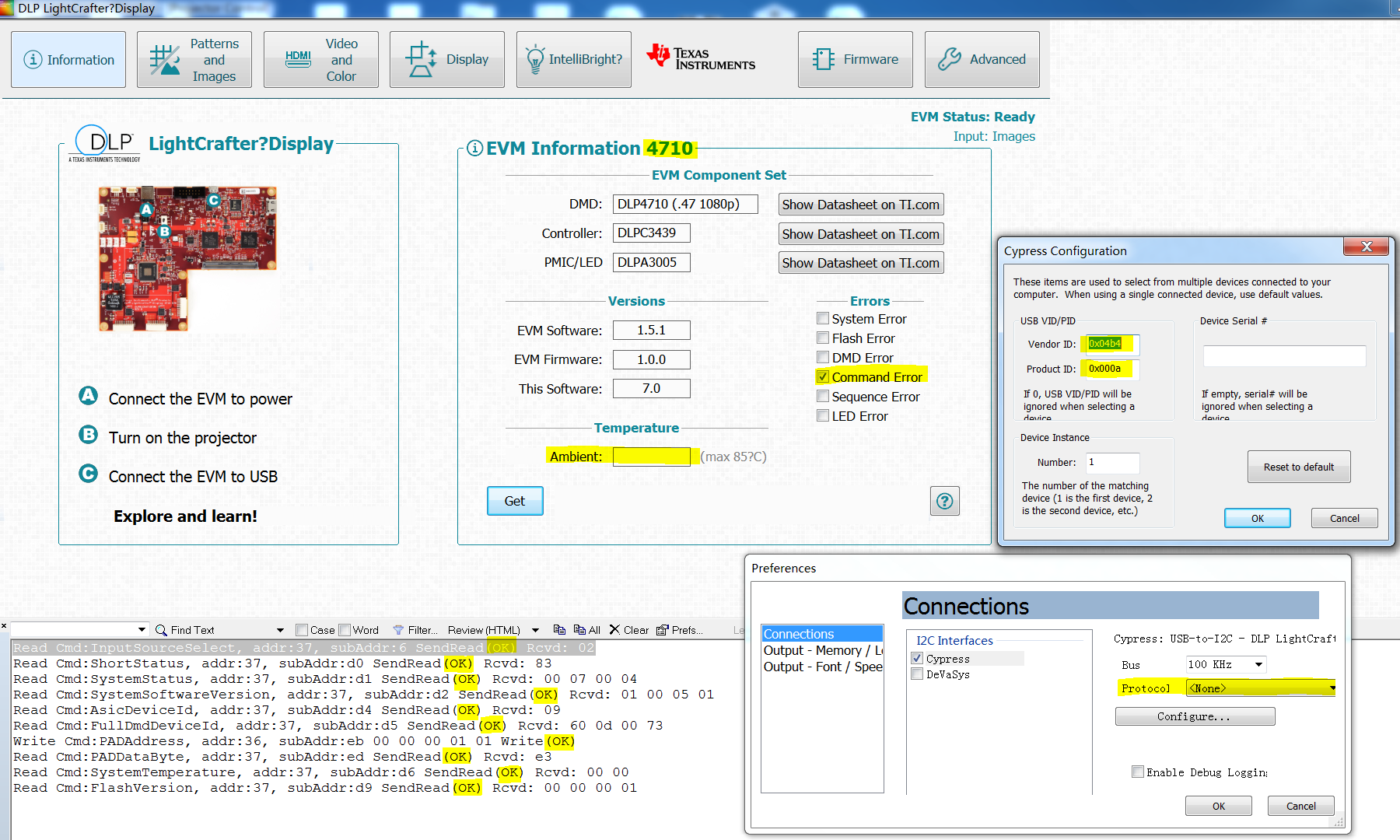

  • Hi Navneet
    Yes.
    I did use the 4710 EVM GUI.
    connections set as follows:
    It seems that the communication is normal, because the command status is all "OK", but there is "Command Error" and the temperature query is also empty.
    Under the same settings, backup and write to the FLASH program failed.
    Is there something wrong?
    Can this GUI only work in I2C mode?
    Is the description in UserGuide wrong?
    How to achieve the FLASH program written in SPI mode?
    JingMingJun
  • Hi JingMingJun,
    Ideally there shouldn't be any error (no command error), and it should get the temperature also.
    In cypress configuration please reset it to default also make vendor and product id to zero. Protocol none is okay. And again try for updating the firmware (I am assuming you are updating the latest firmware available at ti.com )
    During firmware upgrade, both I2C and SPI interfaces are supported. That is, it auto-detects the connection interface and proceeds.
    The command interface supports only I2C but not SPI.
    Navneet
  • Hi Navneet
    I modified the GUI settings and the CypressIC configuration (which I used), and finally I can download the firmware.
    However, the temperature is still not available, and the "Command Error" is still checked.
    JingMingJun
