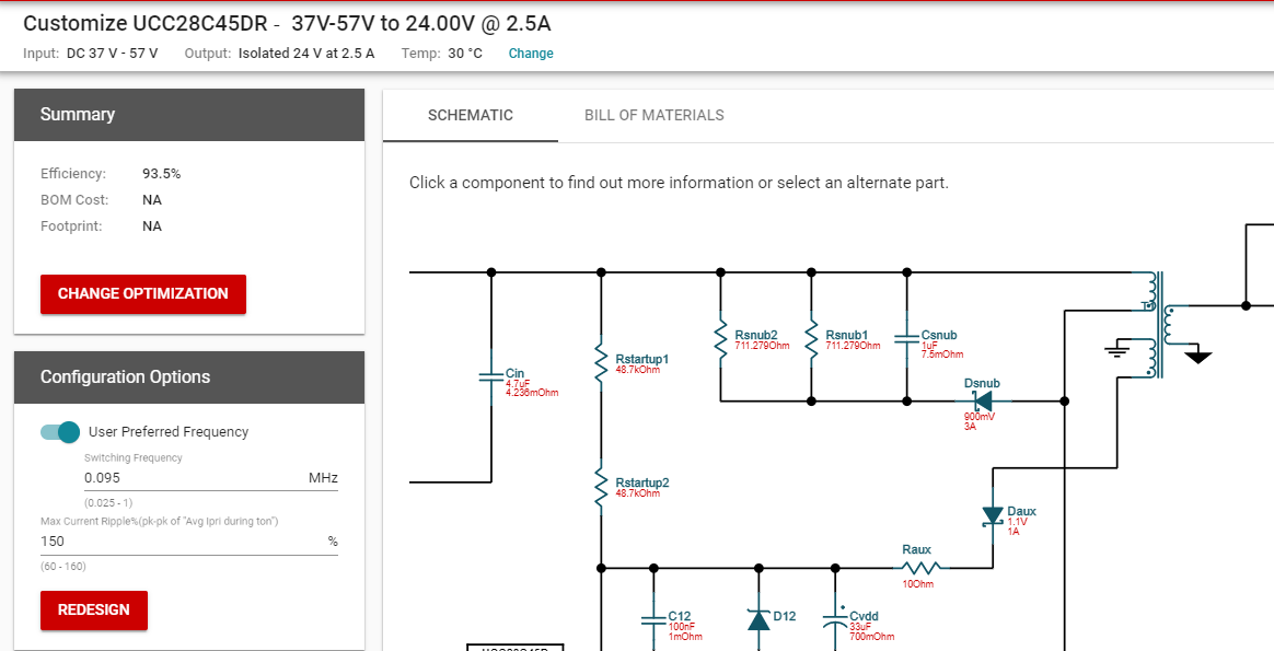

  • Hi Wolfgang,
    I checked the WEBENCH transformer for your condition, I will recommend to lower the switching frequency to bit lesser value like 95 k instead of 100 k(current design), if that works fine for you, from the advanced options in the WEBENCH dashboard window.
    you will be able to get the complete transformer design, which you can share with the transformer vendor, if that works good.

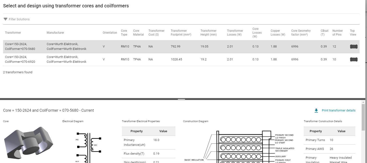

    The transformer is pretty large. I checked the Würth page for data and found that the core is already more than double the volume of the proposed POE62-transformers. This one I chose of it's low height because in the design there will not be enough space, because I have to build in more boards.
    Anyway that's a start. Where can I get access to that transformer builder SW? I didn't find it in my Webench account.

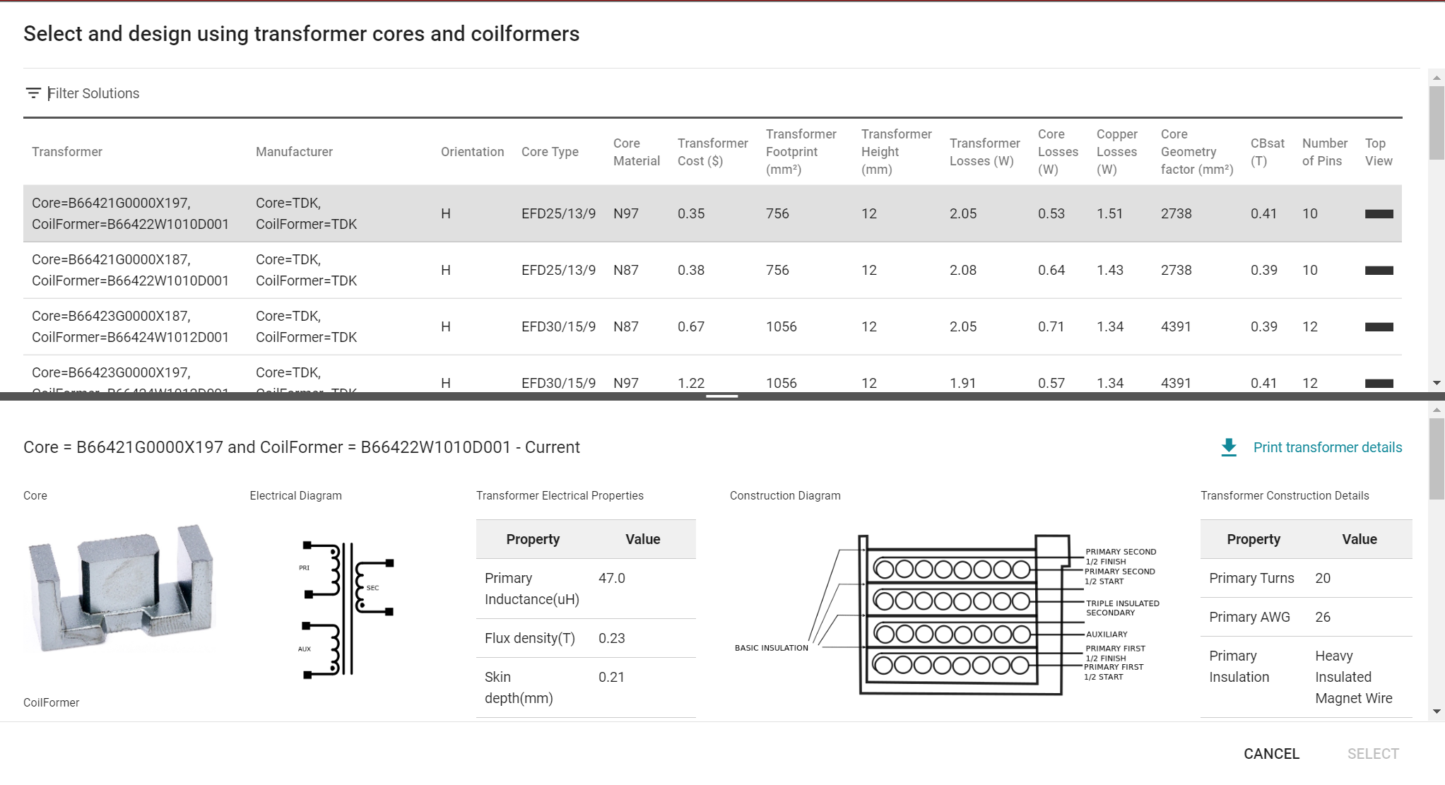

  • Hi Wolfgang,
    How about if we go with UCC28C43 instead of UCC28C45?
    UCC28C43 can operate for higher duty cycles, compared to UCC28C45. Other than this both devices are pretty similar.
    I tried the design for your operating condition with UCC28C43. The design report is below.
    UCC28C43_webench.pdf

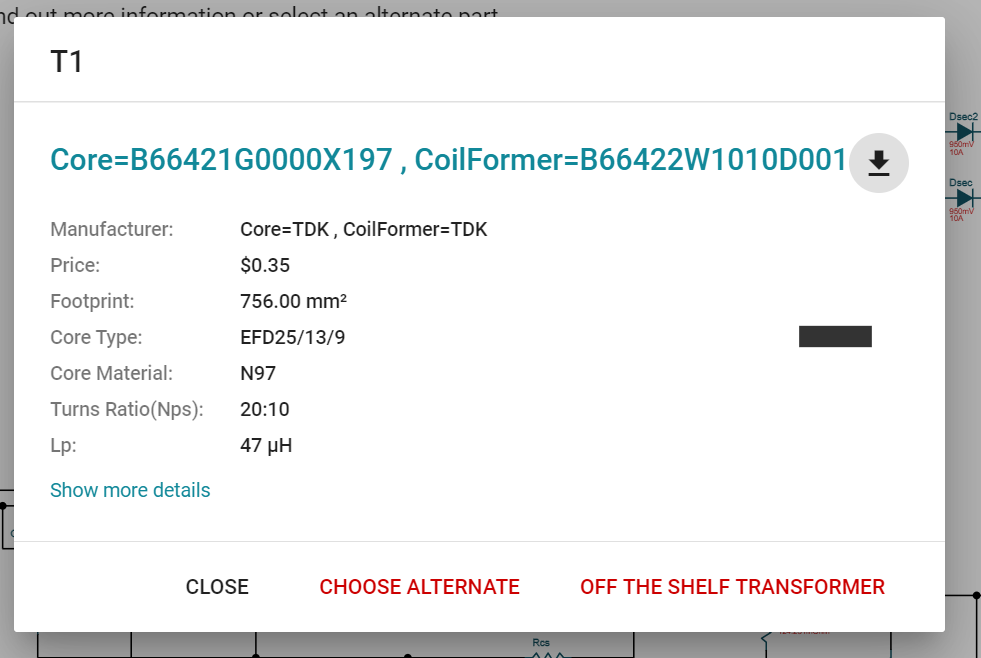

    For this one, i could get smaller transformers, comparable to POE62-
    You can choose any of these based on losses/footprint/tentative cost requirement.
    For your question on checking this window, you can follow these steps:
    a. Open the WEBENCH design from  the product folder of UCC28C43.
    b. In the schematic, click on transformer symbol and click "Choose Alternate"
    c. You will see the transformer window where you can see different types of core/bobbins. You can check out different transformer and their construction parameters.
    d. For printing the transformer report, click on "Print transformer details". on bottom right next to the construction diagram.
