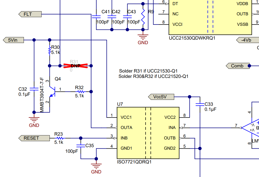

    Let me ask you a question about the gate driver.
    You can see the TIDA-01605 schematic as shown below.
    Currently I am using UCC21530. As mentioned above, I removed R30 & R32 and soldered R31, but the high signal did not go to the enable pin. I confirmed it. Please make sure I am right.
  • Hi jaeyup,
    what is the signal at OUTA and INA of U7 during normal operation? Can you confirm?
  • Hi Xun,
    Currently, I am using the gate driver UCC21530. Soldering was followed by soldering 5.1k ohms to R30 and R32, with the exception of R31. As a result, a PWM waveform is coming out of the gate driver.
    Is Xun telling me to check the waveforms of U7's INA and OUTA in my current circuit?
    If it is correct, the whole circuit is not operated, and the PWM waveform is coming out from the gate driver.
    If yes, can I check the voltage by applying 5V only to the auxiliary auxiliary power source without operating the entire circuit?

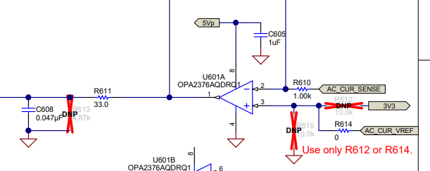

  • ADC_Vac_Vbus_Ii contents of the sheet in the Calculation.xlsx file.
    The ACS716 shown here is different from the ACS716 in the schematic diagram of the TIDA-01604.
    I want to know exactly what the values of Re, Rf, Rfltr and Cfltr are in the schematic of TIDA-01604. Look at the schematic and tell us the part number.
  • Hi, Here is the corresponding schematic snapshot where you could correlates.
