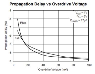

      In regards to overdrive voltage, I pulled these figures from the TLV3501 datasheet:
     From these figures, it seems you should have atleast 40mV-50mV of overdrive voltage above the threshold you have set in the Tina-TI schematic of 25mV. After the confirmations of the answers above, I could help with choosing a suitable amplifier. Also, would you be able to provide your Tina-Ti schematic?

    Note: This might not be the most optimal design for your application, but hopefully it gives you a place to start. I would also run stability and noise simulations like how it's done in the reference design. Also, make sure having a propagation delay of 3-4ns rather than 7-10ns will have a significant effect on your application. If not, this preamplifier would not be very critical; it will only introduce more noise into your design due to the increase of components especially with a 25mV signal. If you can, you should also measure output noise of your transimpedance system to determine which stage will dominate in terms of noise.
