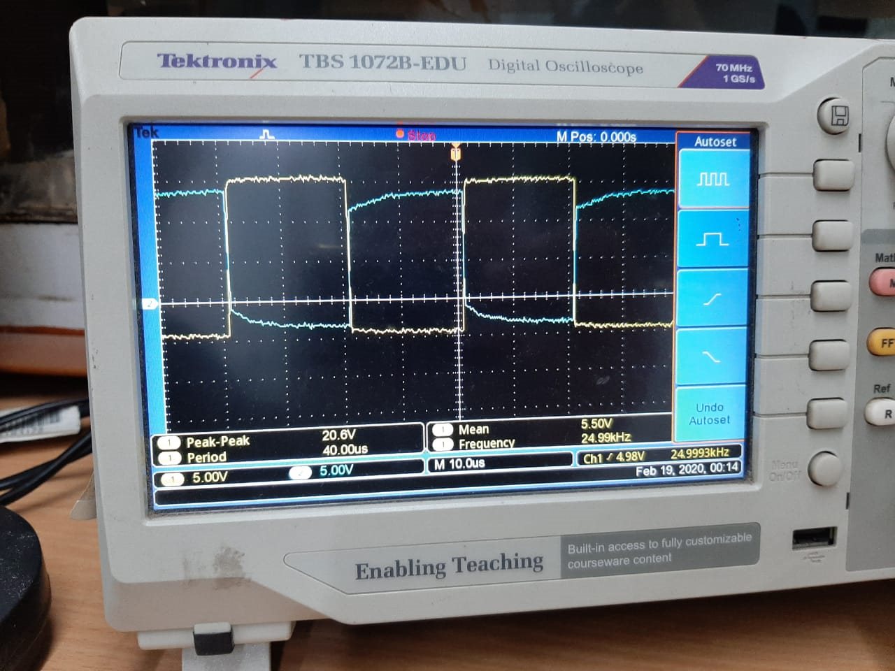

Hello Team TI,

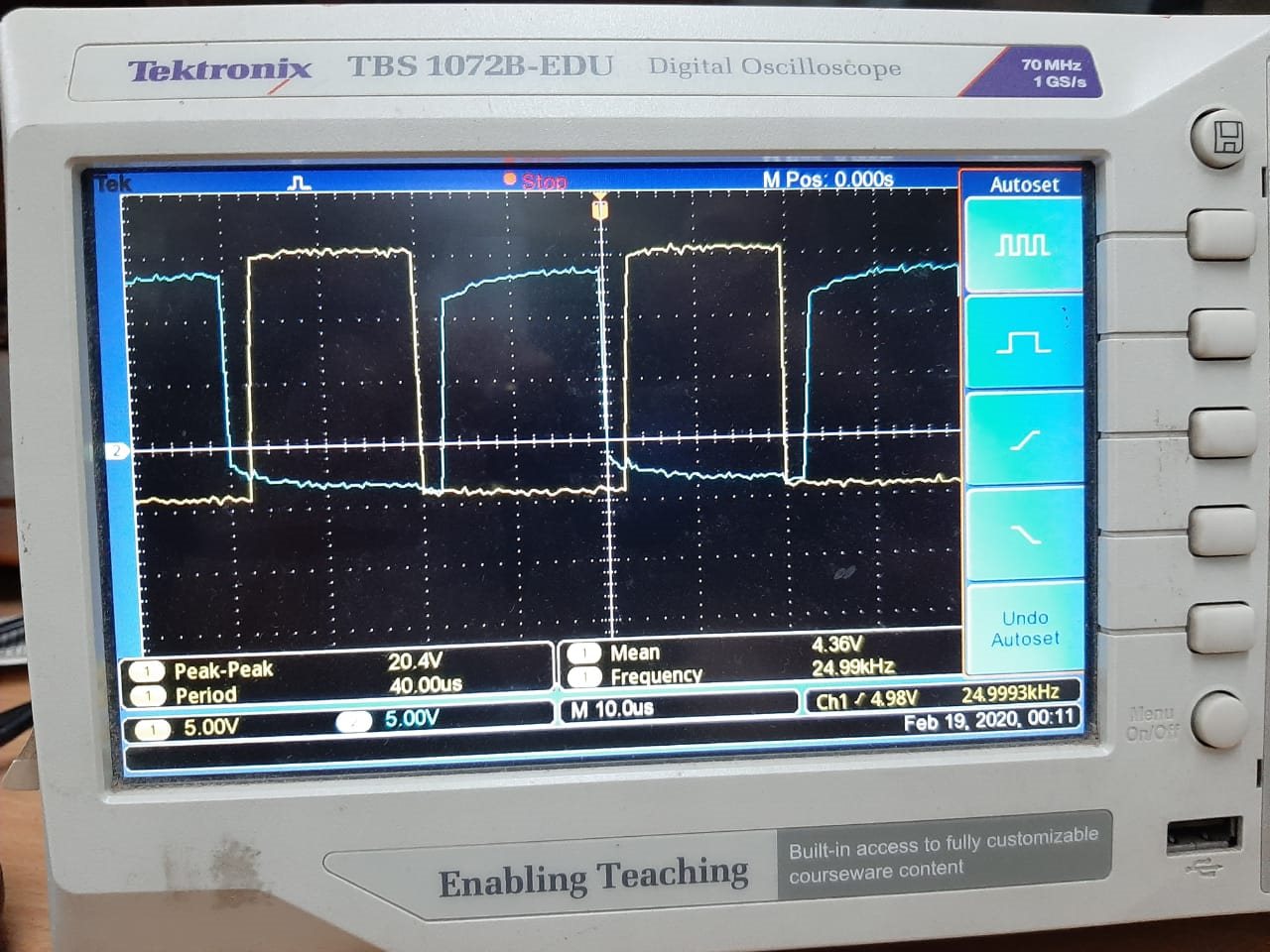

I have tried TIDA-01605 circuit as given in updated schematic. When I gave 5V input supply and Vg1 and Vg2 (pulses from the Launchxl-F28379D) with 25kHz frequency (and with 100kHz frequency too), I found following results. In these results yellow pulses are for switch 1 and blue pulses are for second switch. Here blue one is not 20V_peak_to_peak (+16V and -4V). However, blue one is getting slope also. WHat could be the possible explanation for this? And, how to rectify this problem?
First figure is with 25kHz switching frequency and second figure is with 25kHz switching frequency and 0.22usec dead time.

  • Hello Xun,
    You can see in the results that peak to peak voltage here is 20.6V which should not be more than 20V in any case. We are providing 15V and -4V supply, then output should be around 19V. What would be the possible solution to fix this problem? Is it possible to solve this problem if I increase the gate resistance (Ron) and provide a zener diode for -4V?

  • Hi Utsav,
    Are the probes and oscilloscope settings are exactly same for Ch1 and Ch2?  Can you switching the probes for measuring the top gate and bottom gate and check if it is still the same driver has 20.6V peak to peak?

  • Hello Mr. Gangyao Wang,
    Thank for your reply. Yes,  I checked it. In this case channel 1 (yellow one) will exhibit the same performance as the blue one in previous case. So, I guess there is an issue in hardware side. Moreover, output of G1 and S1 shouldn't be more than 20V. For high frequencies such that 200kHz, It is under 20V because magnitude of flat portion reduces and spikes are of 1V only. However in lesser frequencies such that 100kHz it is more than 20V due to spikes. Is there any solution for the spikes (like zener diode or capacitors)?
