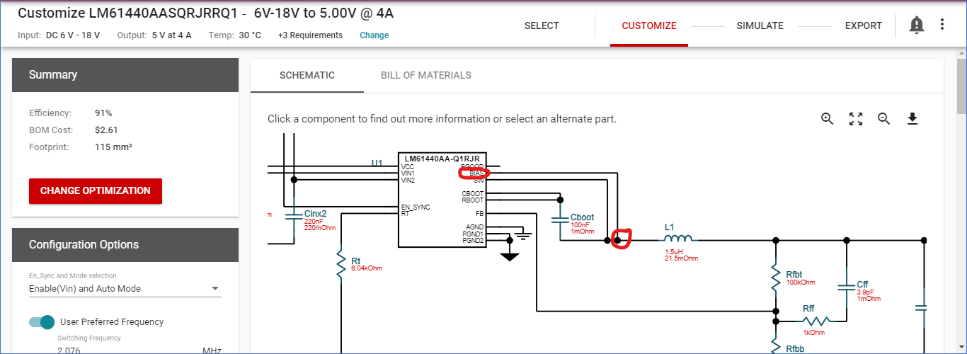

Hello!
I am seeing an issue with LM61440-Q1 simulation where the BIAS pin is connected directly to SW node rather than Vout. BIAS is only rated up to 16V and our input parameters are up to 18V so i see this as an issue. Any feedback as to why the simulation is doing this or is it an error?
