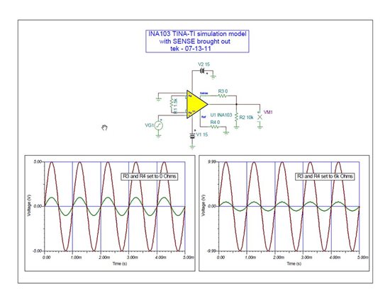

Hi Rick,
I think some people may want to add circuits between the Sense and Output pins, and since you have wired the Sense pin out, how about leave it open? and let the users make the connection as they want?
here is my question:
If I want to break the connection between the Sense and the Output, how to modify the model?
Cary
Cary,
Sorry for taking so long in responding, but I needed a little help getting the model modified...
My colleague, Thomas Kuehl, has modified the model.
Macro model alone: 4075.INA103.TSM
TINA test schematic: 5001.INA103_test_01.TSC
We need to do a little work on this to be able to put it into the TINA-TI library, but we'll do this as soon as possible and will make it available as an update. Until then, you can either just copy the symbol out of the schematic and place it in your own, or use the .TSM file using Insert->Macro menu command.
Hope that helps -

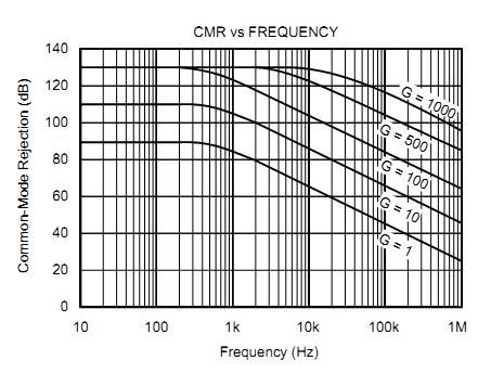

Here I have another question about the model 1NA103:
According to the datasheet, the CMR should go stronger with a larger G factor. as shown below:

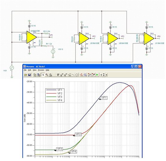

But the simulation in TINA showed us a reversed result, which is attached below:
VF2: G=1000
VF3: G=100
VF4: G=10
which one is right? datasheet or simulation?

sorry, the pictures are missing, now i uploaded them again.
VF2: G=1000
VF3: G=100
VF4: G=10

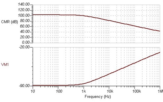

Cary,
What you've plotted is the AC response of the circuit, not the CMR. Those curves show you 20*log(VFx) plotted against frequency, where VFx is the output voltage from the amplifier.
Using the test circuit that I posted the other day, with the amplifier configured for a gain of 5, and 1V in, I get 5Vp out. If I then tie the two inputs together, what I'm interested in is how much signal comes out - that's VM1 in that circuit. But the CMR is the ratio of the output for a regular differential signal to the common mode signal output. So, to get the plots to look like you expect, use the post-processor and set up a new waveform with the equation 5/VM1, and plot that on a Linear-dB scale. Here's what I get:
Hope that makes sense. Good luck!
