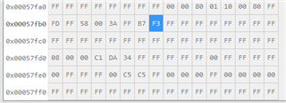

After build, the hex file's VDDR_CAP area value is 0xF3 and the power consumption is high.
But when I change this value to 0xFF, the power consumption is lower.
Both of the functionality are well.

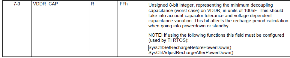

The description of this area as below, but I can't understand what it is meaning. And I also don't know where I have config it in my project.
Could you help me?

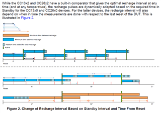

But the way, I want to know what the relationship between the bosh picture things(up and down).
