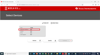

3.I had a connectivity problem when using RTLS_UI with 595-LAUNCHXL CC26XR1+595-BOOSTXL-AOA.
It appeared the blink red led for 5 second before green Led both attach AoA antenna to CC26XR1 or dissemble it out
Then I start RTLS_UI, It could not detect the address of this board , but the others were ok could detect the address and RTLS_UI was working properly. (starting with green Led immediately and be able to detect the address.
Please see in the attachments 1,2.
Please kindly give me some advice step by step to fixing this isseus.

    3- Make sure no other application is trying to access the same COM port. For example, make sure you have closed the programming tool, any other instance of the RTLS_UI, your IDE, etc.
