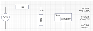

• The duplicated logic is to simulate the ignition of the truck battery when the power supply is insufficient. The test circuit diagram is as follows:
• TBOX is started by Bluetooth. The power supply voltage of TBOX is 4.0V. A 40 ohm resistor is connected in series on the circuit, and a 10 ohm resistor and S1 switch are connected in parallel between the positive and negative poles. S1 switch is off by default.
• Step 1: Use the switching power supply to power on TBOX, and disconnect S1. At this time, the main power voltage of CC2640R2F is 2.327V, and the measured voltage between SWD and GND of CC2640 CJtag is 2.327V;
• Step 2: Close S1 switch, measure that the voltage between SWD and GND of CC2640 CJtag is 1.77V, then disconnect S1, measure that the voltage between SWD and GND of CC2640 CJtag is still 1.77V, then quickly close and disconnect S1 switch, about 500-1000 times, the voltage between SWD and GND will still be 0V, and then whatever operation is done later, the voltage output of SWD and GND of CC2640 CJtag will be 0V, It is not enough to increase the power supply voltage. It can only be restored after resetting or powering off.

    If I understood correctly from your image and description, VDDS falls well below the minimum specification of 1.8V during the truck startup procedure at 0.8V with S1 closed. That should be enough to bring the device to a brownout condition and trigger a System Reset. In this scenario, are you able to read the device's RESETCTL register and see what is the source of the Reset (bit WU_FROM_SD)? Check chapter 6 of the TRM for details.
    A few aspects of your description that I do not fully understand are: what do you call SWD? Is this the VDDS net? How is it showing 1.77V if the resistive voltage divider can only supply 0.8V to the target? How are you measuring this? If using a simple DMM, there might be voltage spikes that may be confusing the meter and I would use an oscilloscope.
    The oscilloscope will also be useful to verify the supply rising/falling slew rate. For details, check table 8-27 of the datasheet.
    At last, keep in mind that noise on the JTAG lines (TMS/TCK pins), can power up the Debug subsystem and which can trigger the device's Halt In Boot (HIB) condition. Check section 5.4 of the TRM for details.
