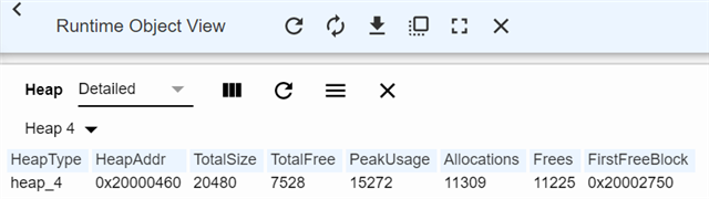

  • Hi Jan,
    I have debugged it and figured out it is caused by a forever loop in heap_4.c. The free memory still has big enough.
    The loop in heap_4.c is
    You can see the pxNextFreeBlock always points to 0x20002900:
  • Hi Patrick,
    Thank you for running this test and reporting back your results! I find it strange that we are finding a circular loop in the next free block structure. Can you share a picture of the call stack? To confirm, this loop is contained within the pvPortMallock() function correct? This will show us where we are calling this function and might provide us with some insight into why we may be getting stuck in this loop.
    Jan
  • Yes, It is in pvPortMalloc(). I am not sure if the below is the capture you want. If not, please let me know how to get it.
