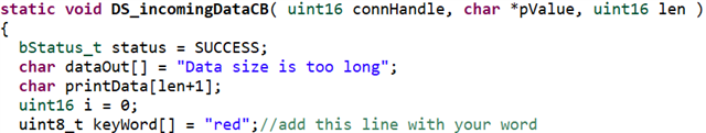

I am testing based on the academy training sample.
SimpleLink data_stream example (ti.com)
I have some suggestion and also I have encounter some problems here.
1. For the app_data_stream.c file part, our academy writes in below.
But it should be written like this, user has to keep printData [len+1], otherwise user aren't able to build the project.
2. I am working on the send Data to the phone when pressing a button part,
I couldn't receive data after pressing the button.
From the project instruction, I saw that there is Callback function in the image.
But based on the newest syscfg., I didn't see this kind of function.
Looks like that is why I can't work well in this project.
I have provided my project in this thread, can you help on check on this?
