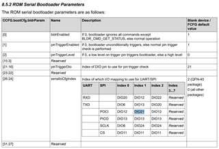

    The first four bytes (0xFFFFFFFF) indicate that XCFG_BC_PBLDR_UNDEF is used (Default FCFG bootloader).  Thus the following bytes (0x03 indicates enabled bootloader and pin entry, 0x015 indicates DIO21) are not used.  From the TRM:

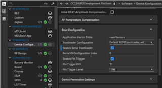

    This should still be valid for a DIO21 low bootloader pin entry, and I've confirmed that such a similar setup works for my CC2340R5 device.  What SimpleLink F3 SDK are you using and how did you generate the CCFG settings?  Typically this is accomplished through the SysConfig Device Configuration.
    Ryan
  • Hi Ryan,
    Sysconfig generated the CCFG sector ( like your screenshot).
