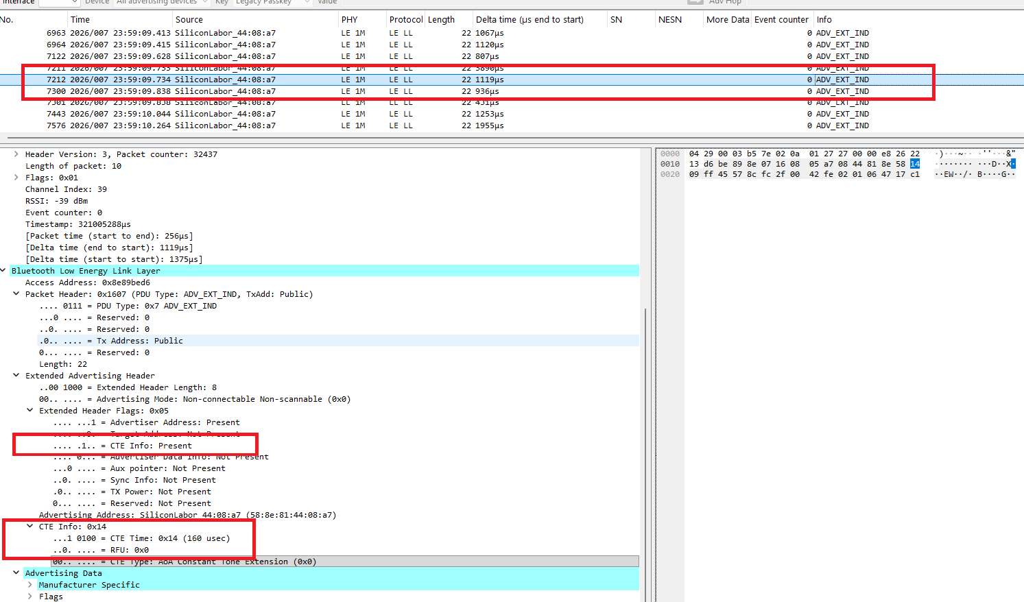

I am using the rtls_responder example project on the CC1352R. With this project, I can observe CTE information in periodic advertisements. However, my requirement is to obtain CTE information in the extended advertisement packets. Please refer to the attached nRF Sniffer screenshot for details.

    The Bluetooth 5.3 core specification Vol 6, Part B, §2.3 specifies which PDUs allowed to be appended with a CTE. In particular, from all of the advertising PDU, only the PDUs from periodic advertisements (AUX_SYNC_IND) are allowed to optionally contain the CTE Info field in their extended header flags. For extended advertisements PDUs (ADV_EXT_IND), the CTE Info field is marked as "Reserved for future use", and should not be used to transmit neither CTE Info nor CTE.
    Since CTE should only be used in Periodic advertising packets according to the Bluetooth 5.3 specification, we do not support adding CTE to extended advertisements PDU.
