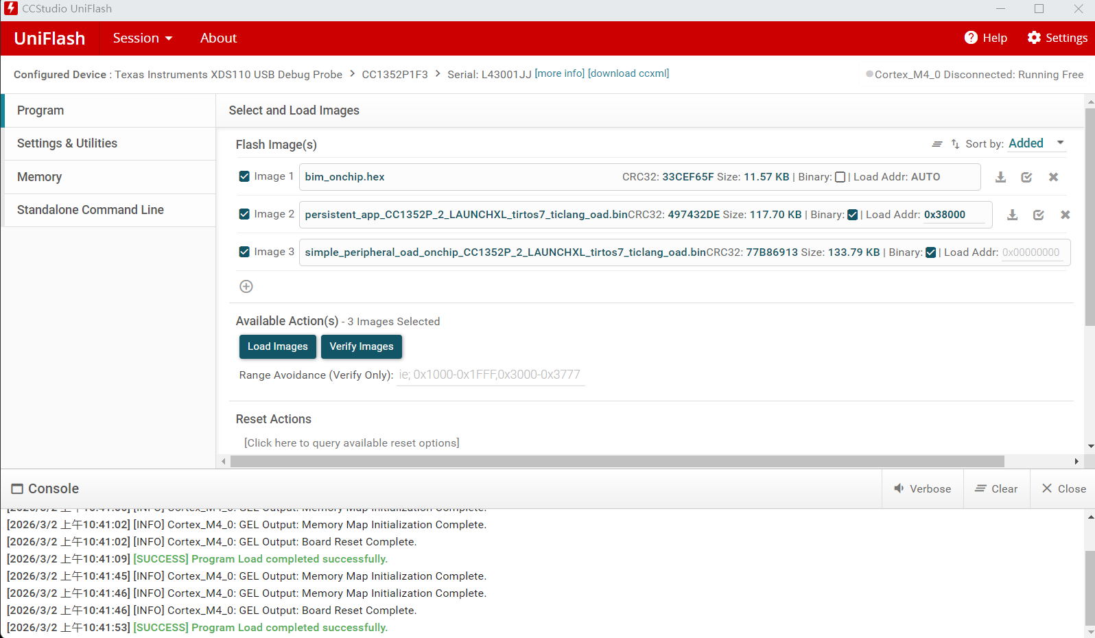

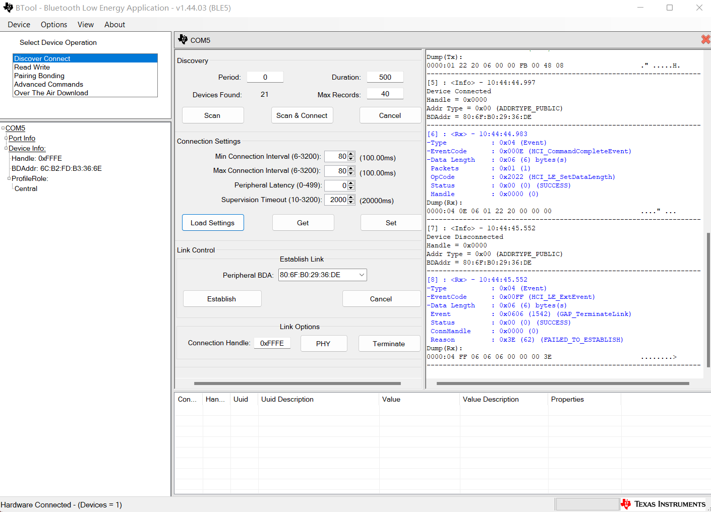

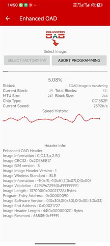

When I was using two CC1352P-2 to implement BLE OAD, I encountered a problem that the BTool tool couldn't connect to the target device. I followed exactly the operations described in the document, but there was a problem where the connection would be established and then disconnected immediately. However, BTool did not report any errors. Regarding the firmware and programs used, all of them were taken from the SDK. The only modification was to set the transmission power of the target end to 20.The mobile phone can be connected to the target device.
Can you help me please?
Below is the log of BTool

[5] : <Info> - 10:44:44.997
Device Connected
Handle = 0x0000
Addr Type = 0x00 (ADDRTYPE_PUBLIC)
BDAddr = 80:6F:B0:29:36:DE
[6] : <Rx> - 10:44:44.983
-Type           : 0x04 (Event)
-EventCode      : 0x000E (HCI_CommandCompleteEvent)
-Data Length    : 0x06 (6) bytes(s)
 Packets        : 0x01 (1)
 OpCode         : 0x2022 (HCI_LE_SetDataLength)
 Status         : 0x00 (0) (SUCCESS)
 Handle         : 0x0000 (0)
Dump(Rx):
0000:04 0E 06 01 22 20 00 00 00                      ...." ...
[7] : <Info> - 10:44:45.552
Device Disconnected
Handle = 0x0000
[8] : <Rx> - 10:44:45.552
-EventCode      : 0x00FF (HCI_LE_ExtEvent)
 Event          : 0x0606 (1542) (GAP_TerminateLink)
 ConnHandle     : 0x0000 (0)
 Reason         : 0x3E (62) (FAILED_TO_ESTABLISH)
Dump(Rx):
0000:04 FF 06 06 06 00 00 00 3E                      ........>
