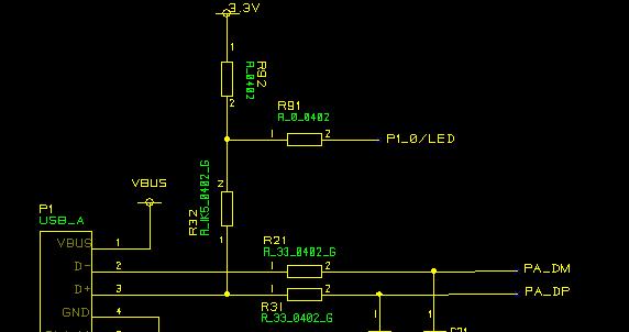

I'm using a CC2540 in my application and have a question concerning the power rails and USB communication. First, from reading other posts I have come to the conclusion that DVDD_USB needs to be connected to the same VDD source as all the other DVDD lines and not the USB power line.
My issue is I am supplying a VDD source of 2.3V off of a switcher and am wondering if USB communication will still operate if my VDD line remains 2.3V during USB communication?
