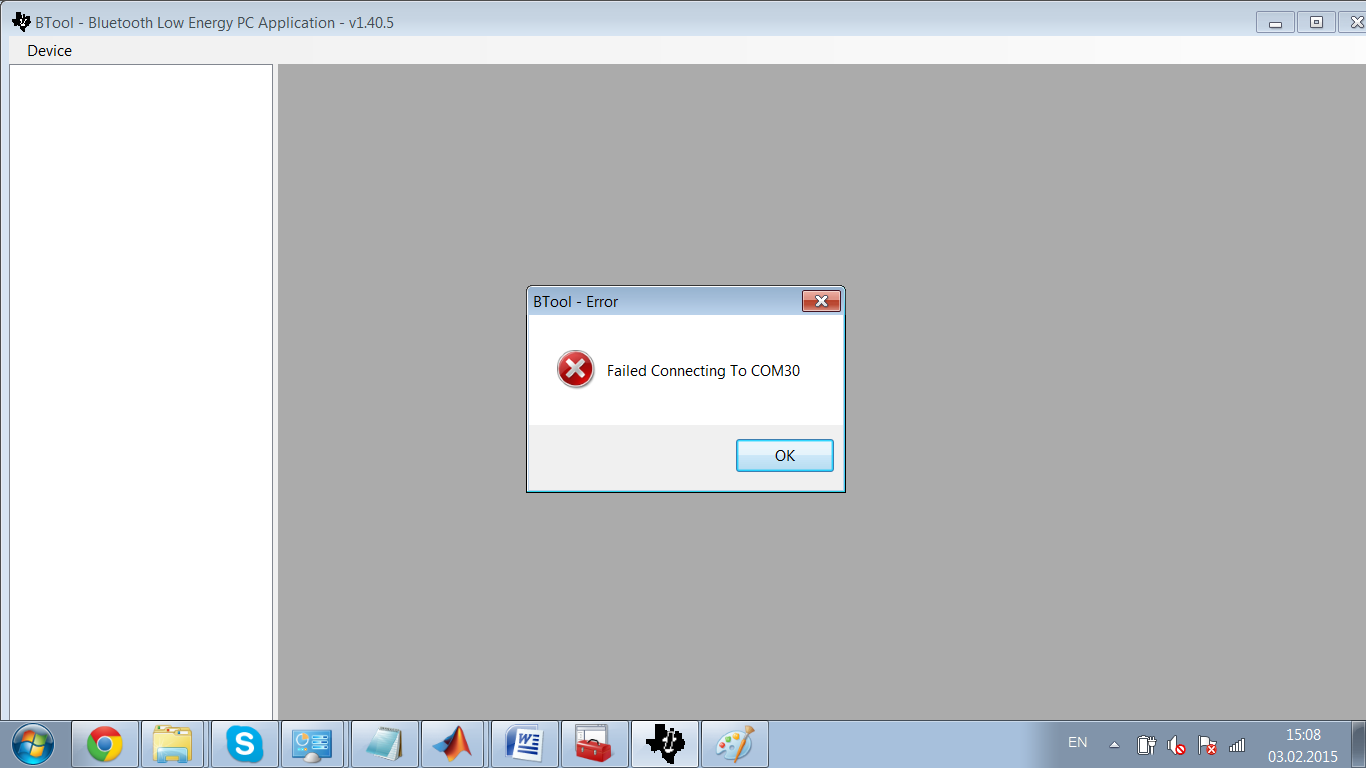

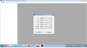

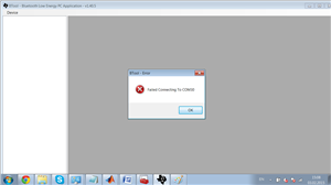

    I'm using external ASUS USB-BT400 adaptor.
    BLE113 module is connected to the custom microcontroller based device using UART. I'm able to transfer bytes and arrays from my device to the smartphone via BLE module as well as send bytes to my device. Now I need to implement more complex functionality such as firmware update so I need desktop application where I can create custom program. Recentely I worked with another bluetooth module from Bluegiga which is Bluetooth 2.0 and I could establish connection and write the script in Matlab with no problems. Now when I try to do the same with Bluetooth 4.0 I faced with the problems that I mentioned in my previous post.
    BTW, I've installed BTool from TI and I couldn't create new device (you can see the images below).
    I hope for your help!
    Dmitry.
