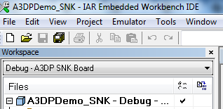

I recently bought the Bluetooth + MSP430 Audio Sink Reference Design (pn: BT-MSPAUDSINK), and I built the A3DPDemo_SNK.eww project using IAR. When I tried to download and debug using the MSP430 FET (LPT), I get this error: "Chosen derivative (MSP430F5438A) and actual hardware (MSP430F5229) do not match. Continue to download?" If I say yes, I get an error. If I change the target uC to a MSP430F5438A in the project, the code doesn't compile. How do I get past this? This is the project that is listed on the literature that came in the demo board box. The SDK/examples I downloaded from the TI website are listed as CC256x MSP430 Bluetopia SDK v1.4R1. Thanks in advance for your assistance.
    Make sure that you select  "Debug - A3DP SNK board" in the workspace tab for BT-MSPAUDSINK, as shown below
  • Thank you for your reply, I didn't notice that there were multiple projects in the workspace. You have moved me down the road a bit.
