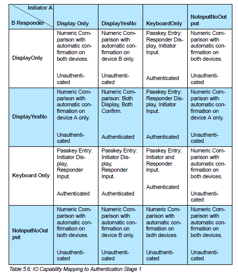

  • Hi Maulik,
    I wonder what the peer device states for IO Capabilities. Below image is from the core spec and it seems like the only way Authentication is guaranteed is if the peer device answers "Keyboard Only".
    Anyway, have you tried to set the pairMode to GAPBOND_PAIRING_MODE_WAIT_FOR_REQ instead. By that you will wait for the peer device. If you have a characteristic with protection set to GATT_PERMIT_AUTHEN_READ in any service, iOS (as an example) will trigger the authenticated encryption automatically.
