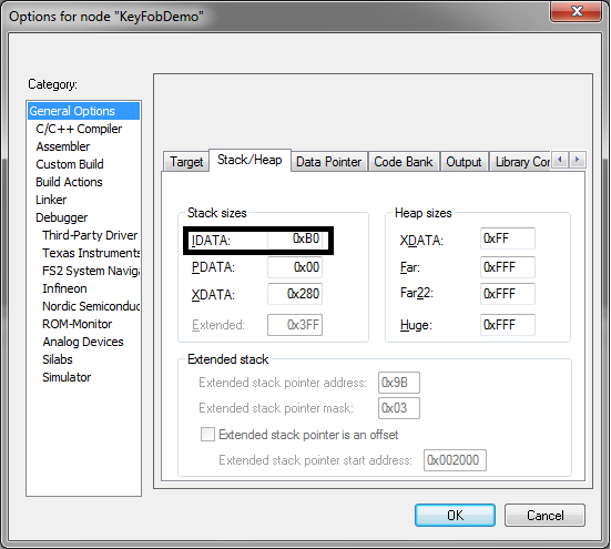

I'm trying compile the example project "SensorTag" that comes with BLE Stack 4.0 into an image that I can upload via OAD. Hence I've set up the project according to "BLE Developer’s Guide for Over-the-Air Download for CC254x Version 1.2".
I've already erased the "+_NR_OF_VIRTUAL_REGISTERS" part from "cc254x_f256_imgA.xcl", to fix the common ISTACK error, and now I receive another error:
Error[e104]: Failed to fit all segments into specified ranges. Problem discovered in segment BANKED_CODE. Unable to place 78 block(s) (0x1e203 byte(s) total) in 0x1bada byte(s) of memory. The problem occurred while processing
the segment placement command "-P(CODE)BANKED_CODE=_CODE_BEG-_CODE_END,_BANK4_BEG-_BANK4_END,_BANK5_BEG-_BANK5_END,_BANK6_BEG-_BANK6_END,_BANK7_BEG-_BANK7_END", where at the
moment of placement the available memory ranges were "CODE:38c8-3ff7,CODE:4b000-4ffff,CODE:58456-5ffff,CODE:68000-6ffff,CODE:78000-7e7ff"
I've tried compiling with optimisation for size, but that had no effect.
