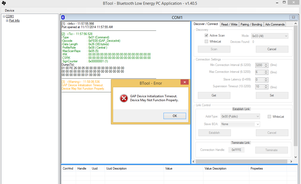

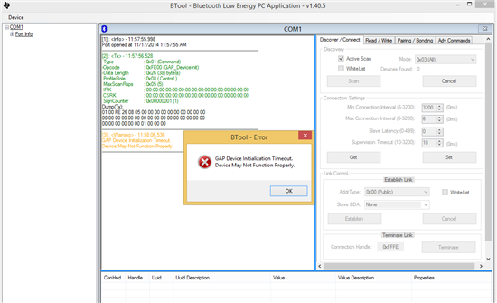

  • Hi Joakim,
    I get precisely the same result. Please see the screen shot below. I have subsequently insured that I am running at a baud rate of 115200 without flow control (set to none). I presume that you mean no parity when you say no control bit. I have tried to set the stop bit to zero but my port (Windows side) won't permit this. So, the stop bit remains one. Any help would be appreciated.
    Patrick
  • HI Patrick,
    You need to configure BTool to use the COM port assigned to the CC2540 mini DK. You mentioned that you now have a COM11 but your screen shot shows BTool is attempting to configure COM1. To identify the COM port associated with the CC2540 mini DK, open Device Manager (under Control Panel) and expand the "Ports" tab. You should see the "TI CC2540 USB CDC Serial Port (COMXX)" listed. The COM port to use in BTool is the "COMXX". Other than the port number, your serial port settings from the screen shot are correct.
    Note that Windows will sometimes change the COM port number assigned to the CC2540 mini DK, so remember to check the Device Manager if you see BTool connection errors in the future.
    Best wishes.
