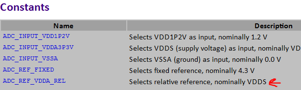

In regards to the Sensor Controller Studio. It is not clear from the documentation what level ADC_REF_VDDA_REL is. I connected a 1 volt bench power supply to to an ADC input and the ADC is measuring 1.305V.

  • Hi Robert,
    Reference material on the constants can be found by navigating to Sensor Controller Studio -> Help -> Sensor Controller Studio Help
    Within this file you can click ADC under Peripherals and it will show you the constant values, functions, etc.
    See below:
    From this chart you can observe the value of "ADC_REF_VDDA_REL" among others. Have you tried using the fixed reference instead?
    As for why the input is reading 1.35V when given 1.0V, I'm not sure about this; Eirik, could you chime in here?

  • How to you calculate the voltage value?
    Have you tried to use ADC_REF_FIXED instead?
    By using the ADC_REF_VDDA_REL the reference will be dependent upon what the VDDS is which is 3.3V when powering from USB on the SmartRF06EB.
