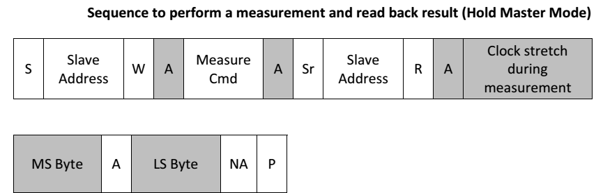

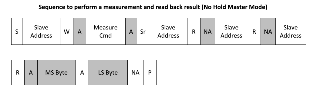

I try to connect a SI7006 humidity/temperature sensor to a CC2640.
For readout, I need to send an I2C command and poll ack from slave to find out, if measurement is finished.
What is the best way to realize that in TI RTOS.
I tried "bspI2cWriteRead", but apparently, the read command does not evaluate ack from slave and does not retry read when NACK from slave.
Next try was to use the following code:
SENSOR_SELECT();  // send slave address
bspI2cWriteSingle(MEASUREMENTCOMMAND);  // start measurement
while(bspI2cRead(data, 2) == false)   // TODO: add timeout!
SENSOR_DESELECT();
Is that a good way to do it? It does not work, but it still might have other reasons.
Alternatively, the sensor has a "Hold master mode"
Is there an elegant way on realizing this on master side with TI RTOS?

  • So far, I have not connected my logic analyser to I2C, and I try to get round this. I have only one single prototype hardware, the only way to contact I2C is to solder to 0402 resistors.
    In your sample code, is there any example that polls ACK? On EEPROM write it should be quite similar?
    Harald
  • So now I have it up and running. The easy way is to use the function bspI2cRead which returns 0 when a read is not acknowledged by the I2C slave.
    So what I do is:
        bspI2cWriteSingle(STARTMEASUREMENTCOMMAND);
        success = 0;
        delay_ms(14);  // this is the expected time to perform measurement
        while ((success == 0) && (errorCounter < 20000))
            success = bspI2cRead(data, 3);  // try to read result
            if (success == 0) Task_sleep(80);
            errorCounter++;
    This works just fine. Stil there is one pecularity:
    When observing on the Logic Analyser, I see two bytes on I2C bus when not successful:
    Why is still one byte read after having a NACK on the slave address?
     Anyway, it works just fine like this.
